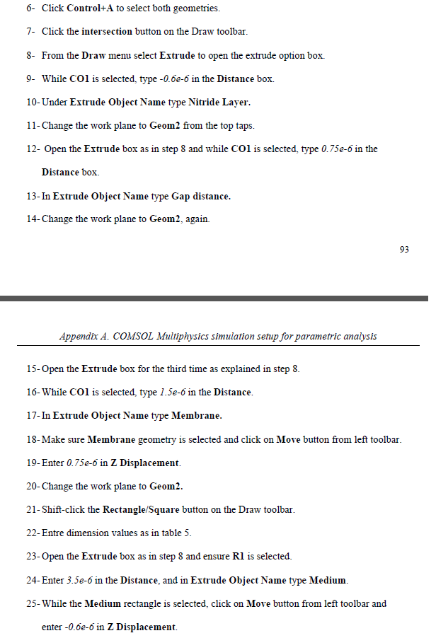

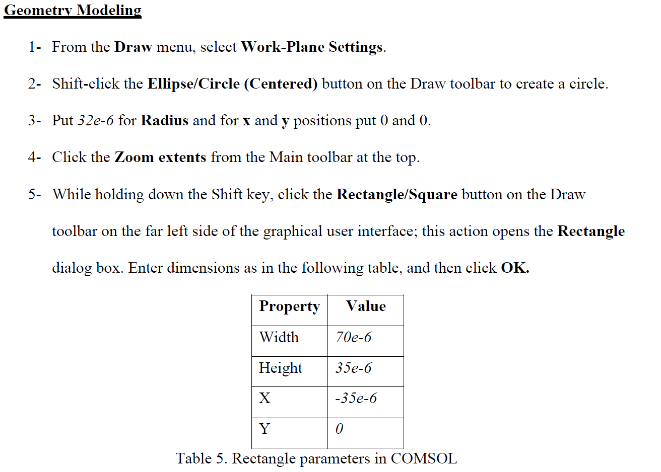

sorry but i have a geometry made on comsol 3.5 i am not abel to build it on comsol 5.2. it is 3 times extrude, but when i am doing the third one comsol take them as one object.
I attached the steps, so if you can please take a look it is simple geometry.
thank you
sorry but i have a geometry made on comsol 3.5 i am not abel to build it on comsol 5.2. it is 3 times extrude, but when i am doing the third one comsol take them as one object. I attached the steps, so if you can please take a look it is simple geometry. thank you
