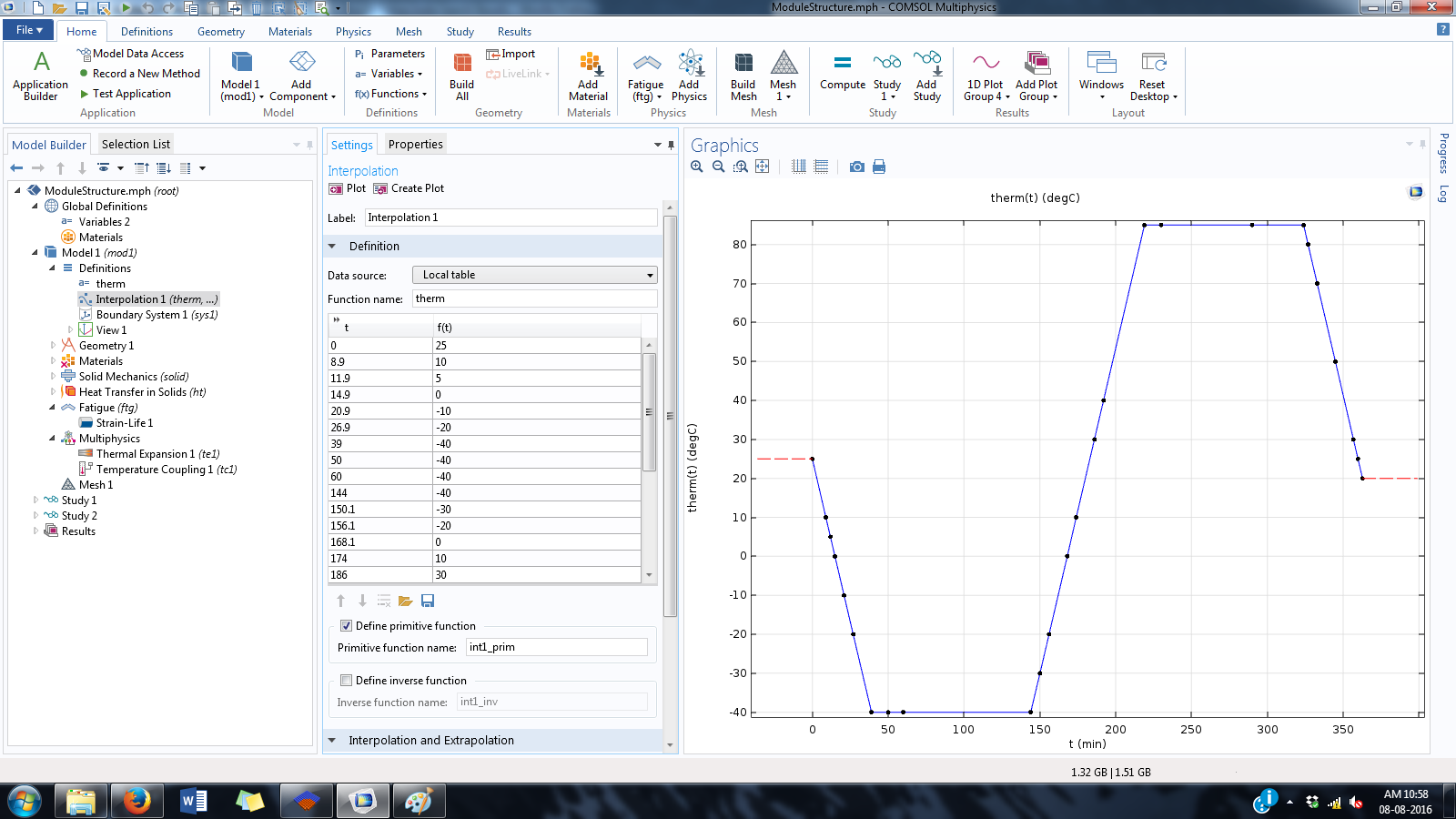

I am new to COMSOL. My work is basically on accelerated testing of PV modules. I wanted to do the fatigue study by using temperature cycle as defined by IEC 61215 standard.
I have constructed the cycle by using interpolation, and called the function as 'therm' with units of argument in 'min' and function in 'deg-C'. Attaching the screenshot (interpolation.jpg) for reference.

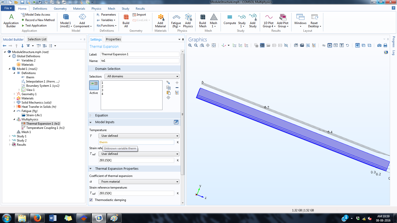

Now when I am calling this function as a 'model input' in the 'thermal expansion' study under the user defined temperature, it is showing 'therm' as unknown variable. Attaching the screenshot (unknown variable. png) for reference.
I have also tried inputting 'therm (t[min])' or 'therm(t), there it shows 'syntax error in expression'.
