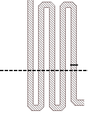

I am trying to integrate the current density norm on a serpentine like metal resistor film as shown in the attached figure. Using quick planes, I can change the location of the plane but I do not wish to cover the entire simulation area (like the dashed line representing the cut plane), instead I wish to define a cut plane with a restricted x and y-coordinate (like the small solid line) so that I can integrate the current density on one arm of the serpentine like resistor. Is it possible to restrict the area of the cut plane?
