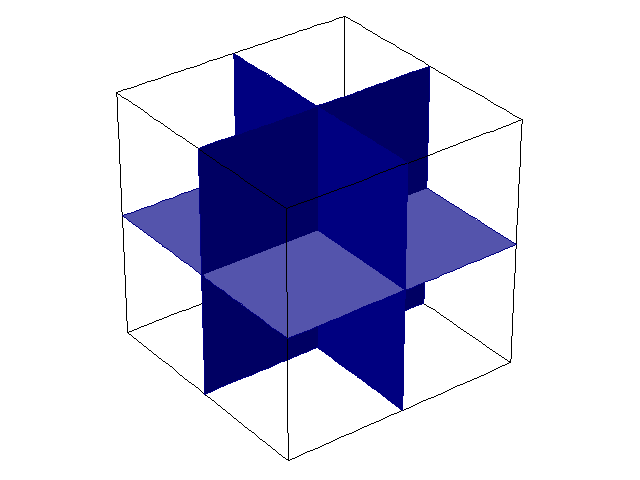

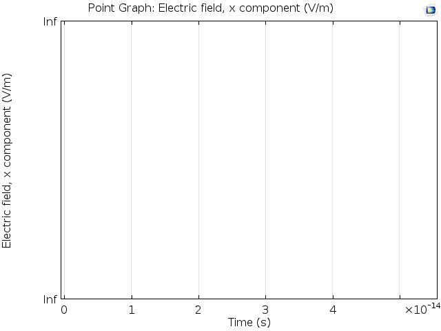

Posted: 9 years ago 30 août 2016, 17:56 UTC+2
Thank you very much Robert ! I appreciate what you did here. I did this thing in my own way previously but somehow that was taking more than 5 hours to compute but then I have done in the way you suggested, took at max 3 mins to compute. I really appreciate it !
However, if I want to put an antenna in the box then the plane wave doesn't go through the antenna. I couldn't even get the electric field along the direction that was estimated previously. I have attached the Ex Vs t graph. I don't know for which reason the plane wave is not propagating through the whole way to the end of the Air box. Is it because the plane wave doesn't get enough time to come to steady state condition before the antenna interrupted the propagation?
I was wondering what is the problem and how it can be solved ? Please let me know. Thanks in advance !

Posted: 9 years ago 30 août 2016, 20:25 UTC+2
I can't tell from the figure. I suggest that you post your .mph file. (Clear the solution and mesh first, to make the file small enough in size.)

Posted: 9 years ago 1 sept. 2016, 00:46 UTC+2
Well, first of all, based on the file you posted, your mesh is much too coarse. Your mesh elements should be much smaller than the wavelength. And your "antenna" would benefit from having a feed (such as a simple lumped element port, which could be based on a line segment connecting your two triangles), even if you only want to consider it as a receiver.
I also notice that your .mph file did not specify any mesh or a solver. Did you intend to use Comsol's defaults? That's seldom the best idea... Anyway, when I suggested earlier to clear the solution and mesh before posting your .mph file, I did not mean for you to remove your specifications of them, but rather for you to choose "Clear All Solutions" and "Clear All Meshes" under the Study and Mesh tabs, respectively. That way, I would still see how you had specified those (that is, assuming that you specified them at all).
Also, I didn't see anywhere under 'Results" where you specified the point/plot at which you wanted to plot Ex vs. time. It's as if you cleared/deleted all your specifications under results too....?
Well, first of all, based on the file you posted, your mesh is much too coarse. Your mesh elements should be much smaller than the wavelength. And your "antenna" would benefit from having a feed (such as a simple lumped element port, which could be based on a line segment connecting your two triangles), even if you only want to consider it as a receiver. I also notice that your .mph file did not specify any mesh or a solver. Did you intend to use Comsol's defaults? That's seldom the best idea... Anyway, when I suggested earlier to clear the solution and mesh before posting your .mph file, I did not mean for you to remove your specifications of them, but rather for you to choose "Clear All Solutions" and "Clear All Meshes" under the Study and Mesh tabs, respectively. That way, I would still see how you had specified those (that is, assuming that you specified them at all). Also, I didn't see anywhere under 'Results" where you specified the point/plot at which you wanted to plot Ex vs. time. It's as if you cleared/deleted all your specifications under results too....?

Posted: 9 years ago 1 sept. 2016, 20:55 UTC+2
1. You do need a finer mesh. You have two planes of symmetry. Consider creating a 1/4th of the problem representation, to help you make better use of your very limited memory. (You will have one PEC plane and one PMC plane of symmetry.) You may also need to go to an iterative solver instead, if the problem is still too computationally large for your computer. Consider getting more memory or a newer computer.
2. Consider plotting log10(temw.normE) for your point plot, so you can see the initial tiny values showing up.
3. For a port, consider putting a line segment connecting your two triangles in the work plane, and extrude that along with the triangles. Then in 3D assign the resulting rectangle there as a lumped port, user-defined, and fill in the details. Use the Comsol help system to guide you on what those details mean. That's how I learned it, so you should be able to also.
4. In your material properties for gold, you'll need to specify a non-zero value of the conductivity (what you called sig_g) if you want to represent, in the time-domain, what would otherwise be a complex quantity in the frequency domain. Do not try to assign a complex number to a material property in a time domain problem, since that would be nonsensical. You can find the relationship between complex dielectric constants and a real dielectric constant with a finite conductivity in any good EM textbook. (And looking that up will help you better understand this topic, so you really should do that.) Choose sig_g accordingly, for your frequency of interest, based on literature you have (or can find) about the known properties of gold at the frequency of interest.
Good luck.
