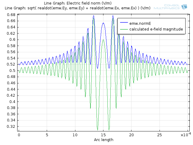

Thanks for the reply. I've recently just made a plot of the magnitude of the electric field including the x and y components, but the x component had a negligible effect; the discrepancy still remained.
Both plots (of the e-field norm and magnitude that I calculated using sqrt(realdot(Ex, Ex) + realdot(Ey, Ey))) have the shape shape, but one appears to be stretched.
I have included a graph of the results for reference. Thanks!
Hi, Thanks for the reply. I've recently just made a plot of the magnitude of the electric field including the x and y components, but the x component had a negligible effect; the discrepancy still remained. Both plots (of the e-field norm and magnitude that I calculated using sqrt(realdot(Ex, Ex) + realdot(Ey, Ey))) have the shape shape, but one appears to be stretched. I have included a graph of the results for reference. Thanks!

Is the E-field norm (emw.normE) the norm of the scattered field or of the total field?
Thanks.
Apologies. The file is too large to be attached in this thread. Is the E-field norm (emw.normE) the norm of the scattered field or of the total field? Thanks.
Posted: 9 years ago 24 août 2016, 12:57 UTC+2
It is the norm of the total field.
