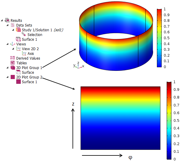

Benjamin, To plot variable as a function of rotation angle and height: 1. Under Data Sets, create Surface 1 node and select cylindrical surfaces 2. Add 2D Plot Group/Surface node and reference Surface 1 data set 3. To control view scale of your (phi,z) plot, use View 2D/Axis and set View scale to Manual Regards, Sergei

Hi Sergei, Thanks for the reply. The surface is made up of 4 surfaces (quarter for each surface) so when I plot them this way, each surface is just plotted on top of each other. I tried to set the scale to the z and angle, but as they aren't a parameter (and cant be) it wont plot. Am I missing something? The model is similar to the journal bearing model in the model library if that helps. Cheers, Ben

Steps to plot flat cylinder are shown in the attached png and mph files.
Sergei
Ben, Steps to plot flat cylinder are shown in the attached png and mph files. Regards, Sergei
