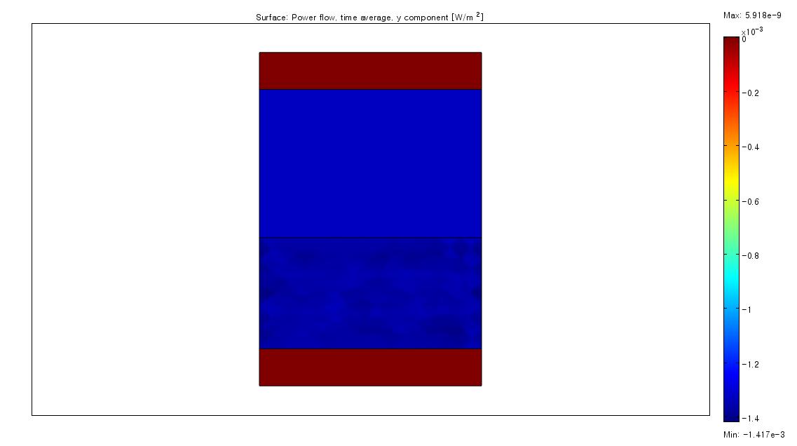

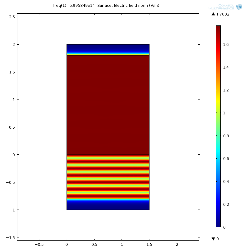

I just start studying COMSOL, and it is very easy simulation, but the result isn't what I wantted. What's wrong with me?
I started with 2D scattered TE wave module. The geometry is attatched as a file. The top layer is a PML, 2nd is a layer with n=1, 3rd is a layer with n=2 and the bottom layer is a PML.
Incident wave is " exp(j*k0_rfweh*y) "
The result attated says 'electric field, norm' is fluctuatiing in the region of n=2, but it's nonsense I think..
There should be only a transmitted wave in the layer with n=2 so that the norm of E field shoudm't be fluctuate.

I would say nothing is wrong !
if you have an electric fied (plane wave) propagating from the bottom upwards, hitting the index interface you have reflection and part of the field is coming back, hence making a standing wave, that you see nicely, but your remaining straight propagating wave is not reflected by the PML so the norm of the filed is constant

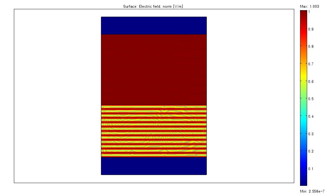

Thank you for your answering!
BUT the wave is propagating from top to bottom. The incident electric field is set as exp(j*k0_rfweh*y), and this is propagating to -y direction. Also you can find from attached file that the power flow is -y direction.
What on earth the problem?!

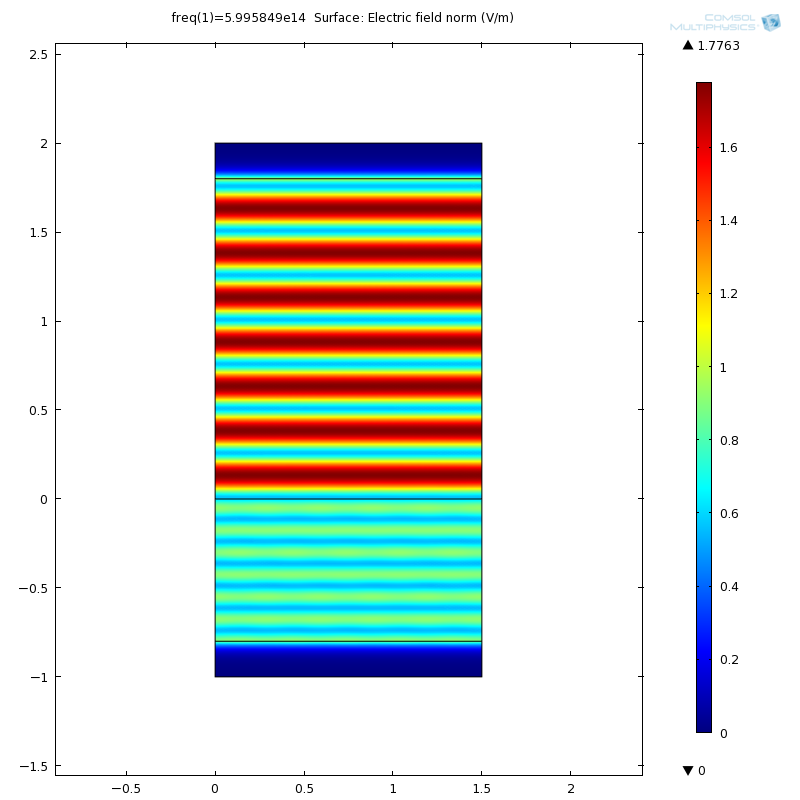

I modelled something similar in v4.1 and it looks like a "upwards" results see attached:
