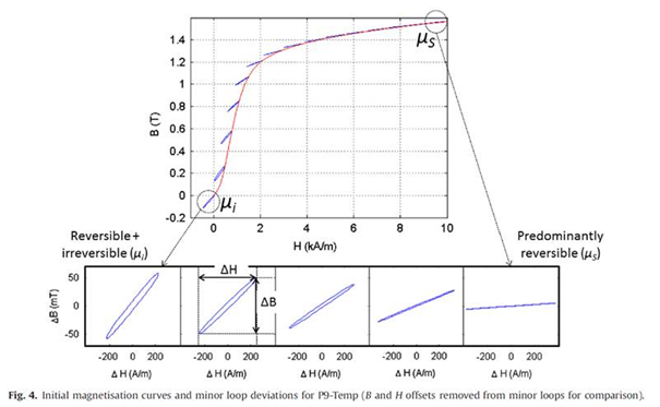

However, this results in a considerably higher permeability value than what I think is correct for small signal excitations, i.e. before saturation of the material. The attached figure (from a scientific paper) illustrates that the slope of a minor BH-loop, i.e. the recoil permeability is considerably less than dB/dH of the major-loop BH-function (e.g. μrecoil=150 compared to dB/dH=1000).

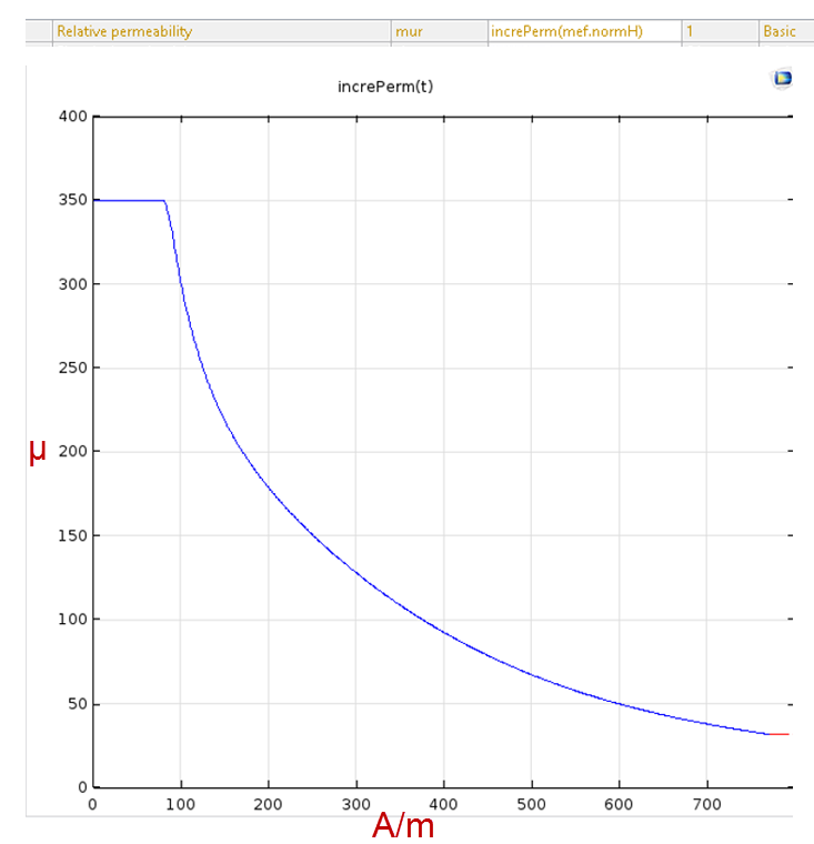

I would like to maximize the permeability used in the frequency domain analysis to a constant value for all dB/dH values exceeding this value, see second attached fig as example.
Is it at all possible to implement this type of material definition where the permeability of the frequency-domain model is dependent of the H-field value of the previous static simulation?
