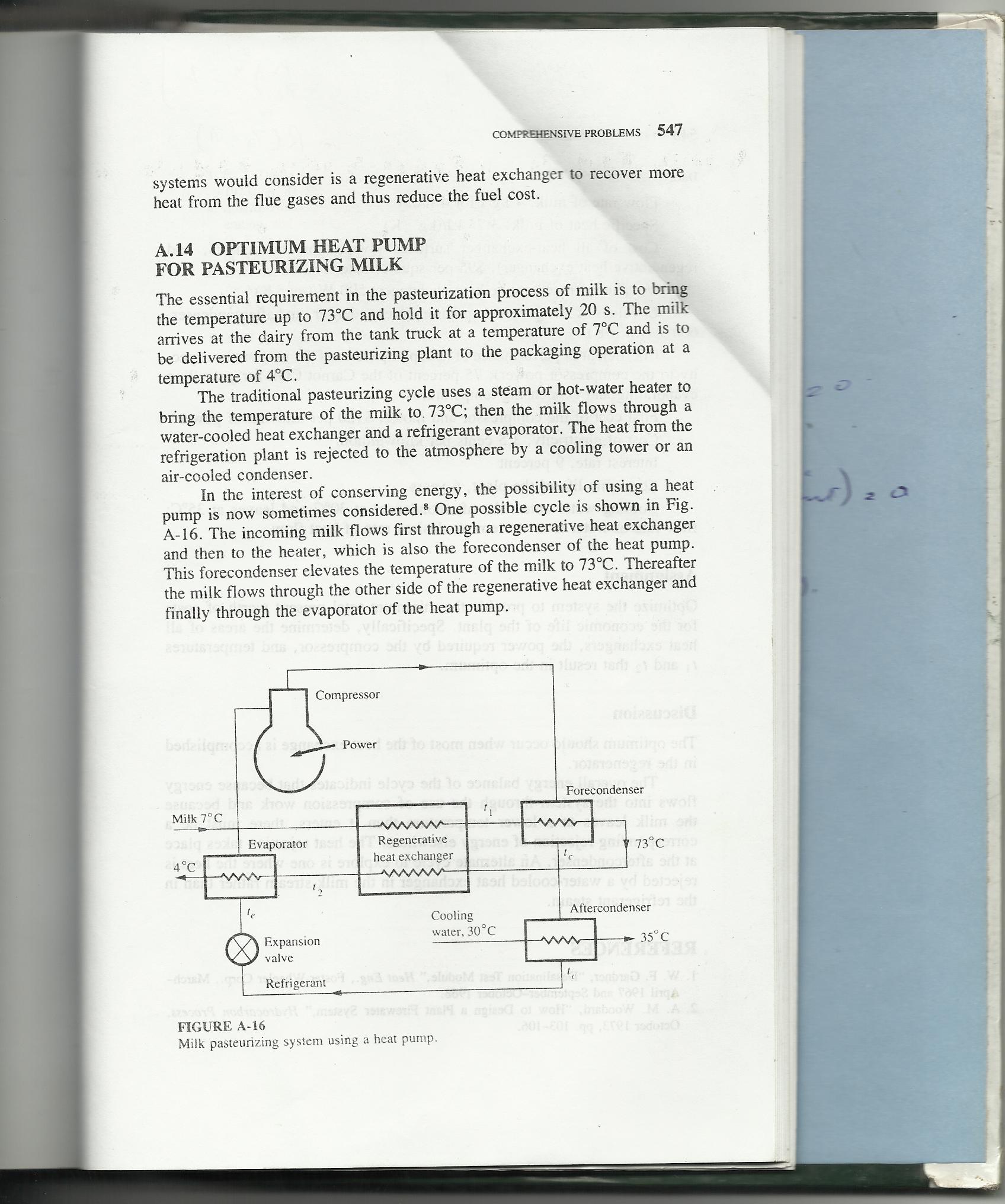

how to do this optimisation?
hello..i want to do optimisation of a heat pump...how to go about..i know engineering equation solver...what and how many equations in this?..plz help me formulate the equations...
what assumptions do i need to make...
thank u
