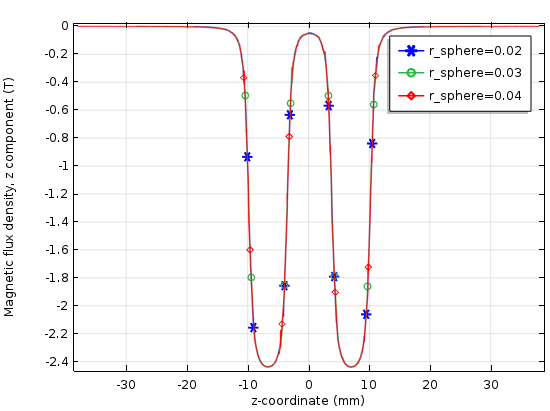

Posted: 9 years ago 26 sept. 2016, 10:50 UTC−4
Christopher,
Attached is your slightly modified model showing that magnetic field distribution remains the same for different air sphere radius.
Sergei
Christopher, Attached is your slightly modified model showing that magnetic field distribution remains the same for different air sphere radius. Regards, Sergei
