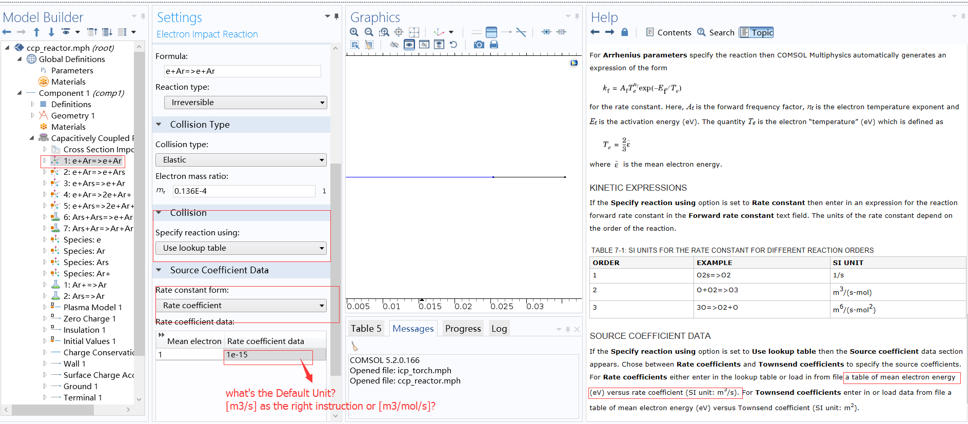

If we press "F1" when the mouse focused on a "electron impact reaction", we can see the following sentences,
"For Rate coefficients either enter in the lookup table or load in from file a table of mean electron energy (eV) versus rate coefficient (SI unit: m3/s). "
I think the unit of rate coefficient used in COMSOL actually is [m3/mol/s], but I'm not sure about it.
Is there anyone who can tell me which one([m3/s] or [m3/mol/s]) is right?

Thank you. But I want to know what is the Default unit when I enter a Rate Coefficient. For example, when I enter a list of electron energy VS rate coefficient,
1 1e-15
2 2e-15
3 3e-15
what is the unit of the second column values in COMSOL, [m3/s] or [m3/mol/s]?

Posted: 9 years ago 7 oct. 2016, 09:50 UTC+2
Are you a user or worker for COMSOL?
Actually for the electron impact reaction, a list of electron energy vs. rate coefficient can be loaded in COMSOL. Please see the attached picture about a snapshot of the "Settings" window.
Are you a user or worker for COMSOL? Actually for the electron impact reaction, a list of electron energy vs. rate coefficient can be loaded in COMSOL. Please see the attached picture about a snapshot of the "Settings" window.
