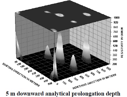

has some one any idea how can I drawing this model

check the forum (search) there are a few discussions how to use ALE to create a meshed volume from an analytical or piecewise / interpolated f(x,y) function
Hi check the forum (search) there are a few discussions how to use ALE to create a meshed volume from an analytical or piecewise / interpolated f(x,y) function -- Good luck Ivar
Posted: 1 decade ago 7 janv. 2011, 19:47 UTC+1
tanks ivar,
but i dont have a Moving Mesh interface or a Deformed Geometry interface.
my geometry represent a layered earth witn inclusions wich have differents resistivities. On surface I assume a number of electrode. In each electrode, I inject current and I want to calculate the potential on the other electrodes.
tanks ivar, but i dont have a Moving Mesh interface or a Deformed Geometry interface. my geometry represent a layered earth witn inclusions wich have differents resistivities. On surface I assume a number of electrode. In each electrode, I inject current and I want to calculate the potential on the other electrodes.

take a look here
www.comsol.eu/community/forums/general/thread/4508/
hope this is what you want
Hi take a look here http://www.comsol.eu/community/forums/general/thread/4508/ hope this is what you want -- Good luck Ivar

Here is a 3D example.
Niklas
Here is a 3D example. Niklas
