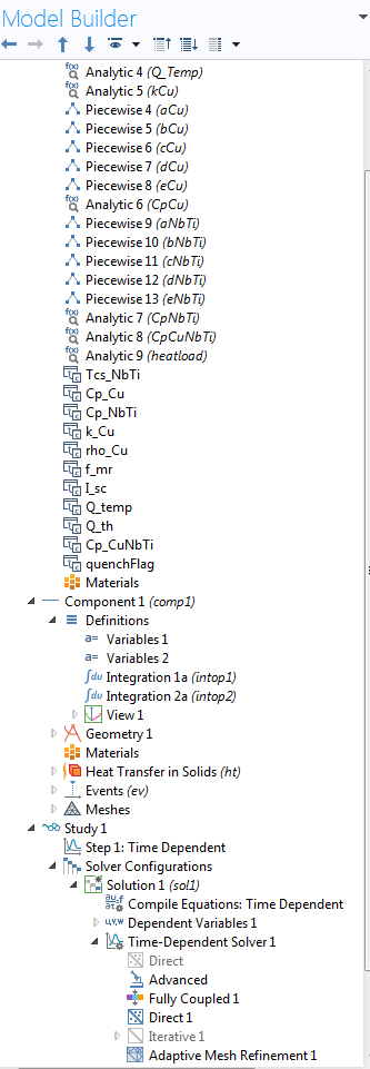

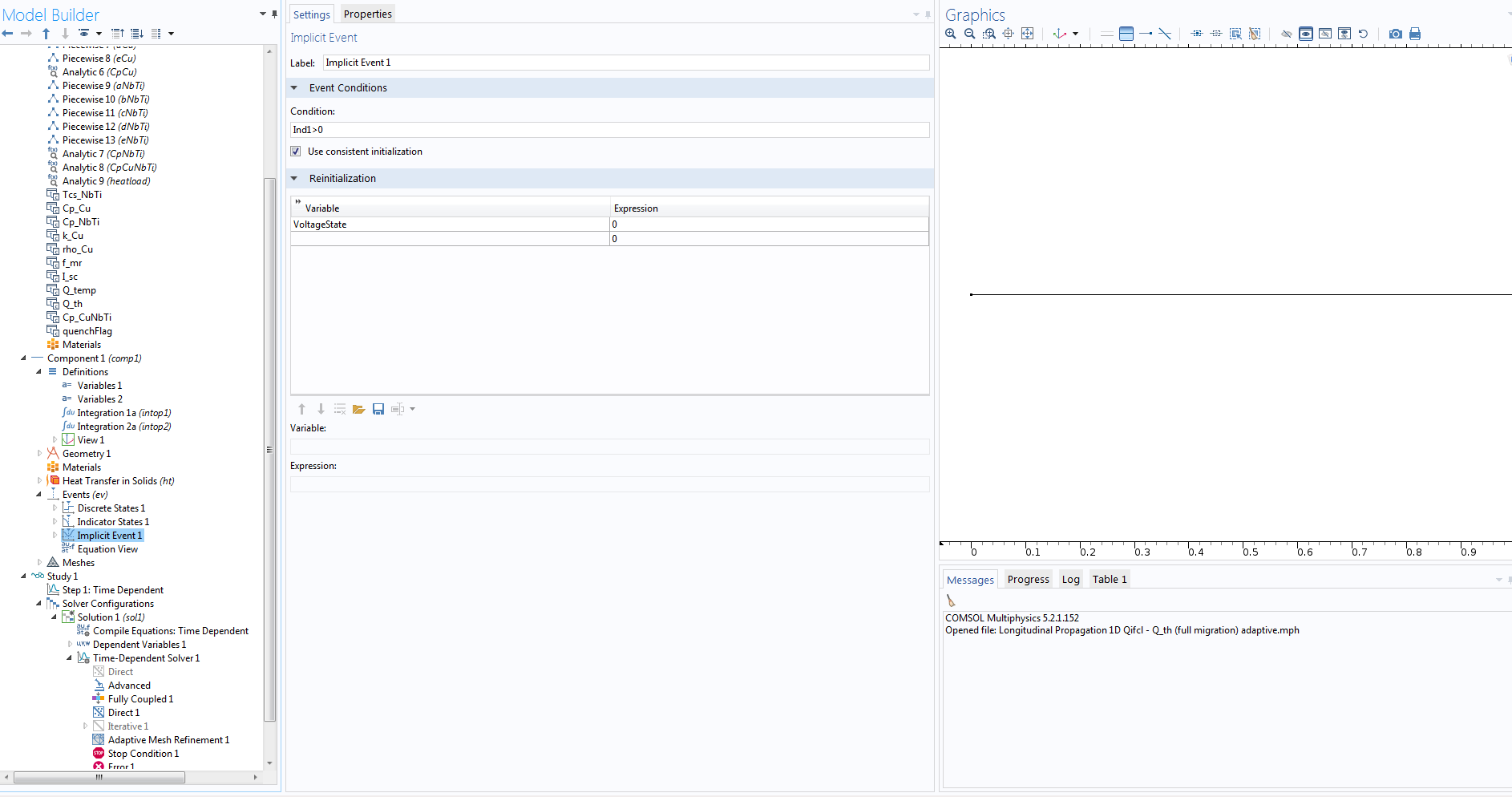

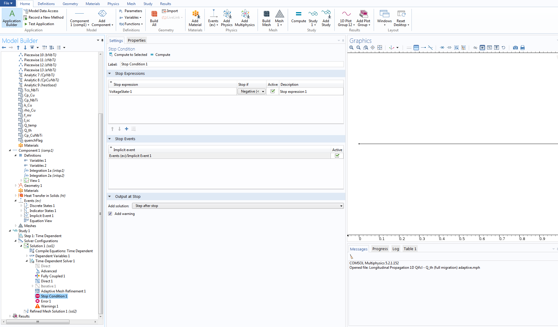

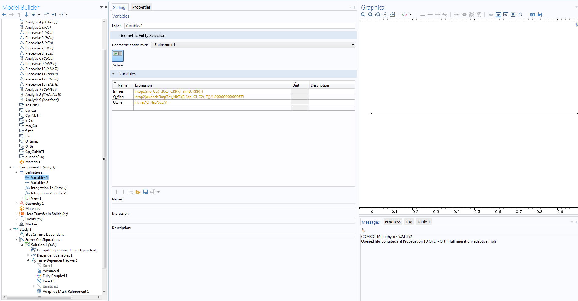

I'm simulation ID wire, and evaluating the voltage over the wire at different time steps. I want the model to use a time-dependent solver, such that the simulation stops when Uwire reaches 0.1 V. The problem is that I do not know how to refer to the variable Uwire in the stop condition. I tried adding an event, but the same problem still persists. How to instruct COMSOL to stop simulating when Uwire reaches 0.1?
The model is too big to attach so please consult the picture.

you would not need events in that case - a stop condition suffices.
I am not quite sure how you measure this voltage though.
More detailed answer could be given in our support when we see your file.
You can always use Study --> reset all solutions to make your file small.
