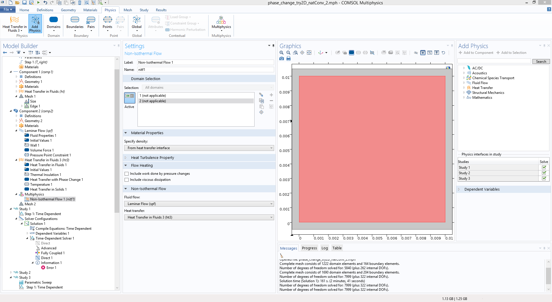

I am adding natural convection to a simulation of ice melting in 2d. I have added laminar flow as well as heat transfer in fluids with a 'heat transfer with phase change' and I have set the domains there for the solid and fluid.
However when I get to the multiphysics component, I am unable to select the fluid domain. All domains appear as 'not applicable'. Please see attached screenshot

I have the following selected
where 1 is the outside solid and 2 is the inside fluid
Heat transfer in Fluids 3 (ht3) : [1 & 2]
Heat transfer in Fluids 1 : [1 & 2 (both overridden)]
Heat transfer with Phase Change 1 : [2]
Heat Transfer in Solids 1 : [1]
in the Laminar Flow domain only domain 2 is selected
the domains which are currently selected seem to make sense, is there a mistake there?
where else could I look to see why I am unable to select the fluid in the Non isothermal flow component?
Are these two modules not able to work together? If so, how do I manually couple the heat and fluid flow?

the ability to combine Nonisothermal Flow multiphysics node with Phase Change Material feature has been introduced in COMSOL version 5.2a. We recommend to update to this version to benefit from this new capability. For further information please contact the COMSOL support team:
