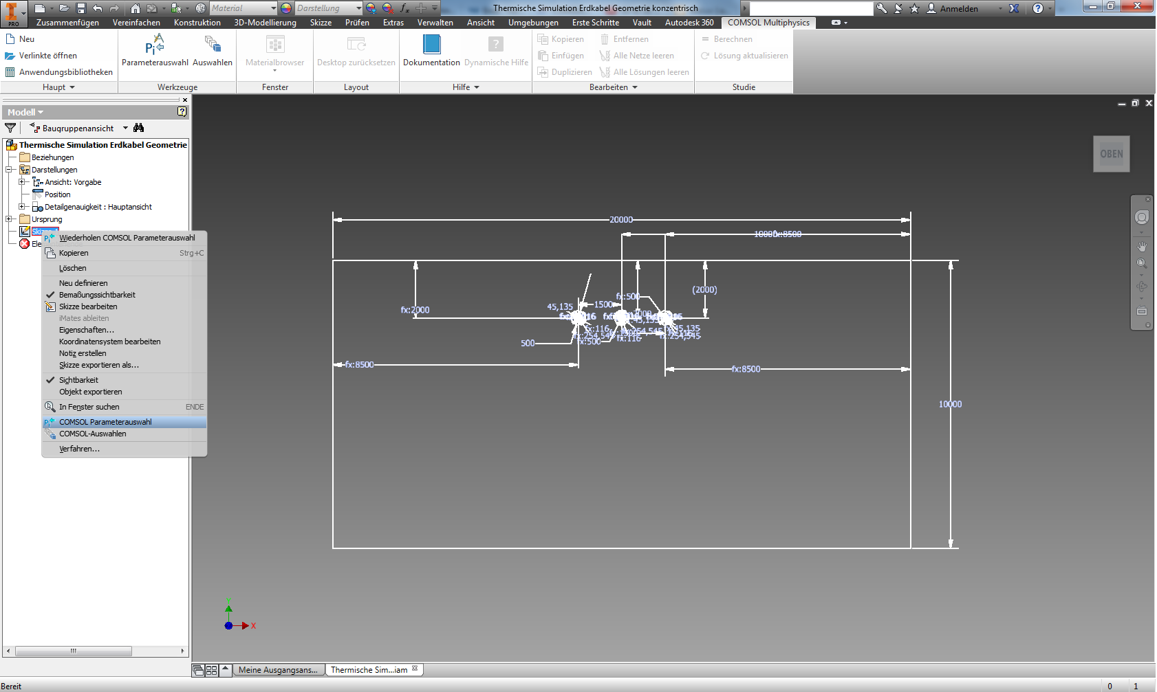

Somehow I'm struggling with the connection between COMSOL and Inventor.

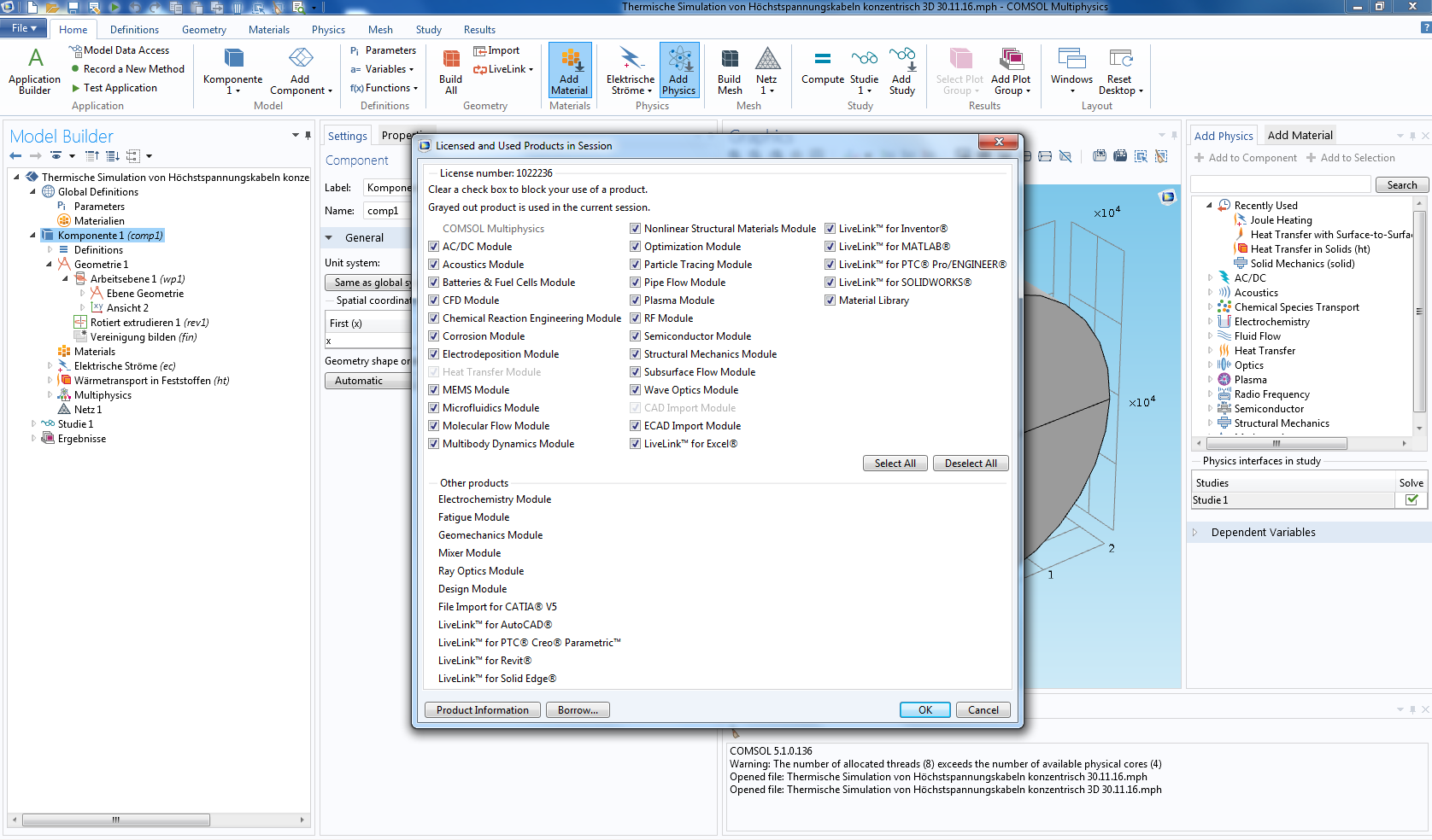

The LiveLink button in COMSOL is not active so could it be that my license does not contain the LiveLink™ module (Picture 2)? I put some pictures in this thread.
Maybe I do something wrong. To get more detailed what I do now is the following:
1. 2D-Sketch in Inventor with definings (parameters)
2. Right-click Sketch and choosing COMSOL Parameter Selection (Picture 1)
3. Enable "Add to COMSOL Model" for all Parameters
4. Export sketch as a .dxf file

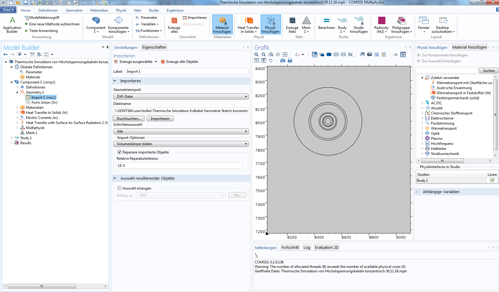

5. Import .dxf file in COMSOL at geometry node
My parameters are not there. So I wanted to try out LiveLink™ but I came to the problems above.
In the manual of LiveLink™ there is nowhere spoken of a .dxf file maybe that's why it does not work. For some reason I cannot find any possibility to save it as one of the data types listed there. If I save it as Parasolid or IGES I cannot import it into COMSOL and I can't find a way to save it as the other data types listed in the manual. Maybe my inventor file has to be 3D? or do I need to start the LiveLink™ through Inventor first? If so, how?
Hope that was not to complicated.
Thanks a lot !
Jan

You can check what products you have access to on your license by going to (in the English language GUI) File>Licensed and Used Products.

Relating to the COMSOL License settings I have the required license for LiveLink (Picture 1).

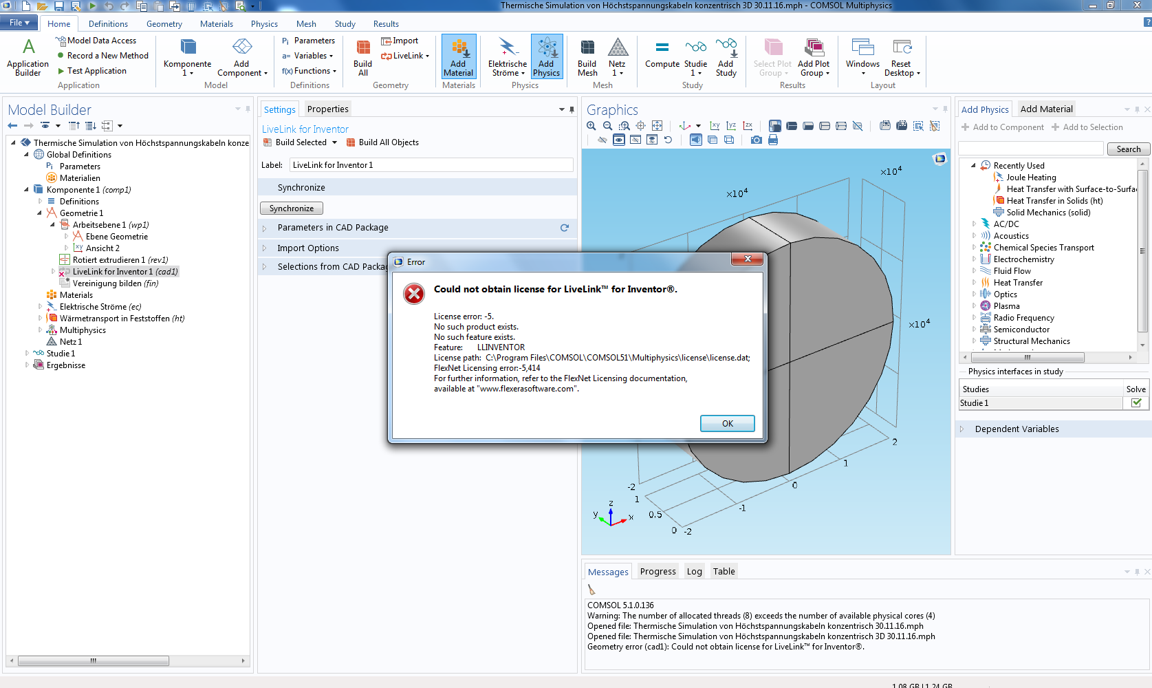

Somehow if I want to synchronize between COMSOL and Inventor the error on picture 2 is displayed.

I am afraid I don't know the answer to the first part of your message, regarding licensing. I'd suggest contacting the support team.
