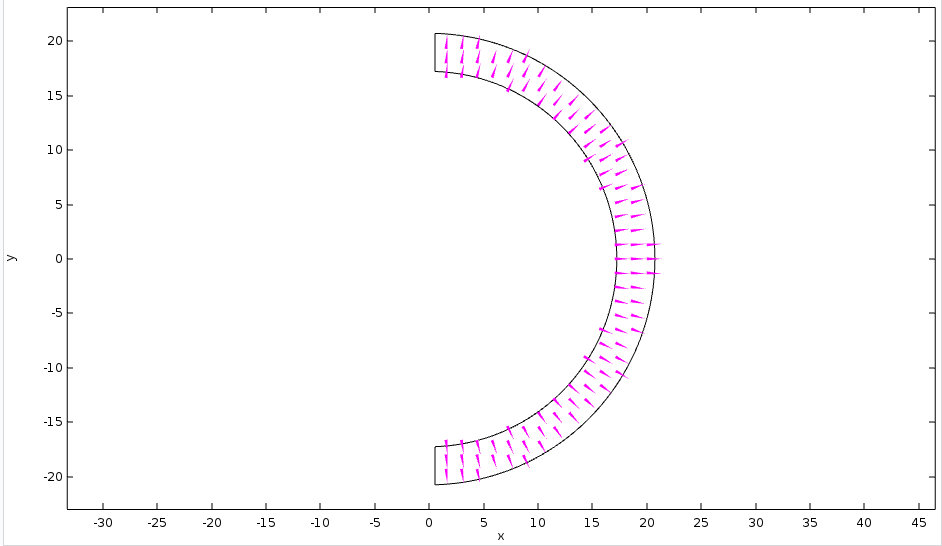

I am trying to simulate the diametrically magnetized arc neodymium magnet in COMSOL 3D. But I don't know how to define the Remanent magnetization of diametrically magnetized arc magnet in x, y ,z coordinates. Can anybody guide me regarding this ?

If it is magnetized across the diameter, then it will simply be a uni-directional vector. I suspect your magnet is magnetised radially, in which case the attached images will help.

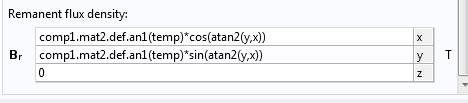

Note that these definitions assume you have attached a BH curve to your material, if you want to assume a linear demagnetisation curve, you can replace the expressions with:
Br*cos(atan2(y,x))
and
Br*sin(atan2(y,x))
and
0
Note that these definitions assume you have attached a BH curve to your material, if you want to assume a linear demagnetisation curve, you can replace the expressions with: Br*cos(atan2(y,x)) and Br*sin(atan2(y,x)) and 0
