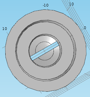

I need help using this software. I want to know how to select my flow area/domain , which needs fluid to flow through my imported complex geometry(say from AUTOCAD).
The geometry is something like a complex pipe with a specific thickness. So when i import the geometry from AUTOCAD to COMSOL, the fluid is flowing through the thickness of my solid geomtery instead of flowing through it. Can anyone help me with this? how do i select the inner area fir my fluid flow/properties.
I need the flow to flow through the inner part, instead of the thickness of the solid geometry.
Can someone please help me with it?
Thanks in Advance

Hey Riya,
may be it es easier to create the geometry using Comsol. If you can not do so you have to close the domain of fluid flow by AutoCad (in/out boundary faces) or using Comsol after you imported your gometry.
If I understand your figure correctly Comsol cannot find a (closed) flow domain.

The functionality you are looking for is called "Cap Faces". It is available in the CAD Import Module, the Design Module or in any of the LiveLink for CAD products. See this blog post which describes it:
www.comsol.com/blogs/meshing-cap-off-for-cap-on/
The functionality you are looking for is called "Cap Faces". It is available in the CAD Import Module, the Design Module or in any of the LiveLink for CAD products. See this blog post which describes it: https://www.comsol.com/blogs/meshing-cap-off-for-cap-on/ Best, Jeff

Thank you Jeff, sorry for the late reply. I am still having a little trouble capping complex geometries like discharge slit of a nozzle, where the slit is a little bit of an angle and not a uniform slit.
Any other suggestions?

I am not sure I understand what you mean by "the slit is a little bit of an angle and not a uniform slit". The cap faces capability can be used to generate complex, non planar capping surfaces, as I briefly mentioned in this thread: www.comsol.com/community/forums/general/thread/128432 .
If problems persist, I would recommend you please contact the support team: support@comsol.com so they can discuss your specific situation in more detail with you.
