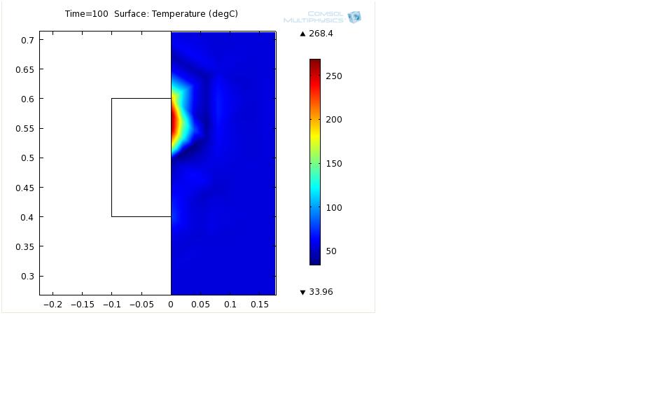

Thanks Xiaoyi for answering!
If I go for manual setup and perform the first simulation (say for example for 100 seconds of heating time) and then get the results. How can I use this temperature distribution as input to the rest of the part of the geometry,which is only in the surrounding of the port area (temperature distribution in the case of RF module away from the source is zero)?
Please find attached an image(RF.jpeg) result of the first part which is related to Microwaves heating(RF Module). After the colored distribution of temperature, I want to start my Heat transfer module using the temperature distribution obtained from RF module and proceed further in the same model.
Can you please give some educated ideas of doing it, if you want to see the model files, I can make the files and post them to you as well?
I have also tried your tip to launch a batch process but I am unable to get the results according to the batch process. I am not sure how to start the batch process? I have saved two files in a folder with slightly different properties of materials (which are expected as a result of increase in temperature) and text file is saved as result.bat in the COMSOL Installation directory in the same format as you mentioned. Double clicking the batch file, I obtained the MS-DOS Window displaying two different commands (as shown in attached figure batch1.jpeg) but after a while this window disappears and nothing happens. I also tried to run both of the individual comsol files one by one but they are displaying just the usual results and no batching is taking place.
Can you please elaborate the procedure for my and other users' knowledge?
Thanks Xiaoyi for answering! If I go for manual setup and perform the first simulation (say for example for 100 seconds of heating time) and then get the results. How can I use this temperature distribution as input to the rest of the part of the geometry,which is only in the surrounding of the port area (temperature distribution in the case of RF module away from the source is zero)? Please find attached an image(RF.jpeg) result of the first part which is related to Microwaves heating(RF Module). After the colored distribution of temperature, I want to start my Heat transfer module using the temperature distribution obtained from RF module and proceed further in the same model. Can you please give some educated ideas of doing it, if you want to see the model files, I can make the files and post them to you as well? I have also tried your tip to launch a batch process but I am unable to get the results according to the batch process. I am not sure how to start the batch process? I have saved two files in a folder with slightly different properties of materials (which are expected as a result of increase in temperature) and text file is saved as result.bat in the COMSOL Installation directory in the same format as you mentioned. Double clicking the batch file, I obtained the MS-DOS Window displaying two different commands (as shown in attached figure batch1.jpeg) but after a while this window disappears and nothing happens. I also tried to run both of the individual comsol files one by one but they are displaying just the usual results and no batching is taking place. Can you please elaborate the procedure for my and other users' knowledge?

If I understand you correctly, you mean in your model the geometry for the RF module and for the Heat Transfer module is different, i.e., for the RF module, the geometry is the colored one, while for the Heat Transfer module, the geometry is the empty one, according to your RF.JPG. And what you want is transfer the temperature distribution in the colored geometry to the empty geometry as the initial values of the second simulation, right? If that, I don’t know how to do it, as you see, these two geometries have different size. Maybe you can contact the Comsol support for help.
For your second question, make sure you have input the command lines correctly. I found, from your batch1.JPG, in your first command line you missed .mph for the mw_batch1. You said “after a while this window disappears and nothing happens”, what do you mean for nothing happens? Have you checked the files mw_batch1out.mph and mw_batch2out.mph, since the simulation results will be stored in these two files.

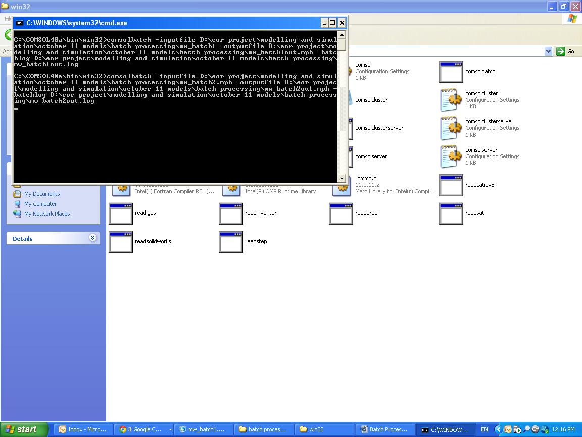

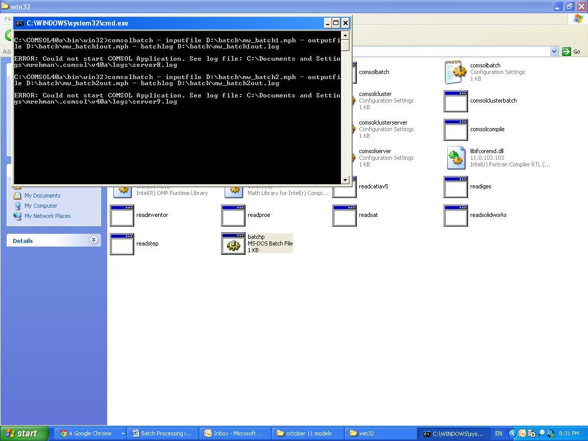

In the geometry it is only one geometry with one fluid inside the box but I am getting the temperature distribution only in the area across the boundaries of source.There is no temperature change deep into the fluid after 10-15 cm. I want that as the initial heat propagation across the boundaries has been done by radiation heat transfer, similarly the rest of heat transfer should be done by conduction and/ or convection deep into the fluid as radiations will not reach deep in to the fluid. Does COMSOL consider it automatically or should I have to incorporate it by myself? If I have to do it by myself, how can I do that, any idea?
For the batch processing, I have made the correction in the batch file but still did not get any thing as I am confused about the process. I will write in detail what I did, please correct me if I am wrong?
I have two comsol files which I want comsol to run one after the other by using batch processing. I have stored them in D drive. I wrote the lines mentioned in the attached word document and stored it as batch.bat in the C:\COMSOL40a\bin\win32 directory.
Then I run this bat file, it opens DOS window with two lines appearing on the screen one after the other as shown in the figure and vanishes after a moment. Then I checked my folde of D drive where I have stored my comsol files but there are no out put files available. Should I make two COMSOL files as output as well? If yes, should they be empty?
Please clarify the whole procedure.
I will be obliged to you.
Thanks and regards,
Thanks a lot Xiaoyi for your feedback! In the geometry it is only one geometry with one fluid inside the box but I am getting the temperature distribution only in the area across the boundaries of source.There is no temperature change deep into the fluid after 10-15 cm. I want that as the initial heat propagation across the boundaries has been done by radiation heat transfer, similarly the rest of heat transfer should be done by conduction and/ or convection deep into the fluid as radiations will not reach deep in to the fluid. Does COMSOL consider it automatically or should I have to incorporate it by myself? If I have to do it by myself, how can I do that, any idea? For the batch processing, I have made the correction in the batch file but still did not get any thing as I am confused about the process. I will write in detail what I did, please correct me if I am wrong? I have two comsol files which I want comsol to run one after the other by using batch processing. I have stored them in D drive. I wrote the lines mentioned in the attached word document and stored it as batch.bat in the C:\COMSOL40a\bin\win32 directory. Then I run this bat file, it opens DOS window with two lines appearing on the screen one after the other as shown in the figure and vanishes after a moment. Then I checked my folde of D drive where I have stored my comsol files but there are no out put files available. Should I make two COMSOL files as output as well? If yes, should they be empty? Please clarify the whole procedure. I will be obliged to you. Thanks and regards,

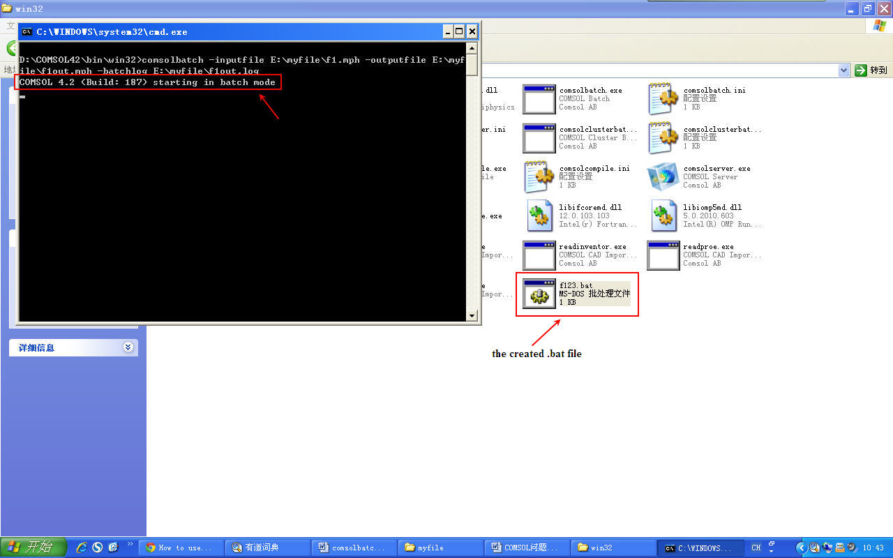

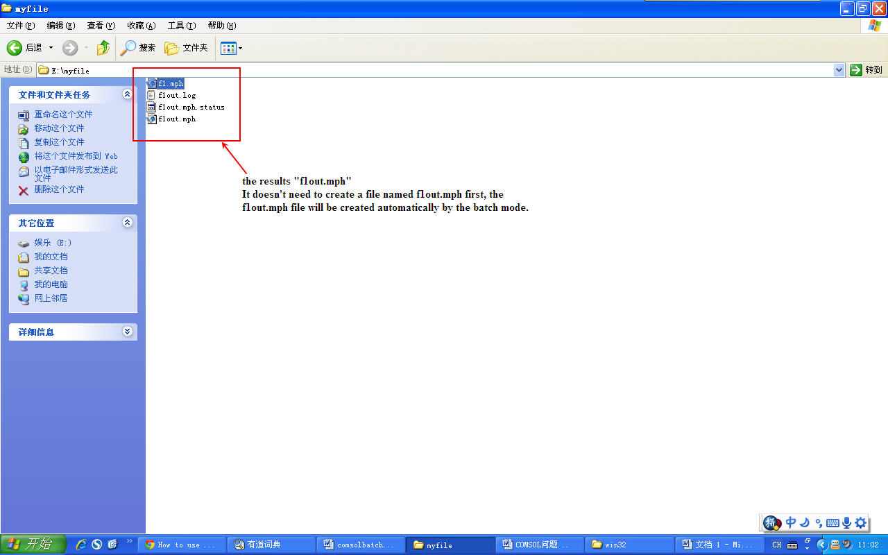

I don’t know why your batch mode didn’t work. I have tried this function again, and it worked, you can see the attached “picture1”. Now I will write out the steps again (just as an example).
1. create an .mph file, and save this file as E: \myfile\f1.mph
2. open the notepad, that is Start-all program-attachment-notpad, and write the below command:
comsolbatch -inputfile E:\myfile\f1.mph -outputfile E:\myfile\f1out.mph -batchlog E:\myfile\f1out.log
Choose the file types as all files, and save this file as D: \COMSOL42\bin\win32\f123.bat (see attached picture1).
3. double click the file f123.bat to run (see the attached picture1)
4. check the results (see attached picture2)
Thanks and regards,
Hi, I don’t know why your batch mode didn’t work. I have tried this function again, and it worked, you can see the attached “picture1”. Now I will write out the steps again (just as an example). 1. create an .mph file, and save this file as E: \myfile\f1.mph 2. open the notepad, that is Start-all program-attachment-notpad, and write the below command: comsolbatch -inputfile E:\myfile\f1.mph -outputfile E:\myfile\f1out.mph -batchlog E:\myfile\f1out.log Choose the file types as all files, and save this file as D: \COMSOL42\bin\win32\f123.bat (see attached picture1). 3. double click the file f123.bat to run (see the attached picture1) 4. check the results (see attached picture2) By the way, for your failure running, I’m not sure whether it has something to do with the windows operation system or the Comsol version. My operation system is windows xp, and the Comsol version is 4.2. For your first question, actually I don't quite understand what you described. Maybe you can send me your model file if you don't mind. For your this sentence "Does COMSOL consider it automatically", in my opinion, Comsol is just a software, so it will not consider anything like a human brain, what it will do is what you asked it to do (your settings). [QUOTE] Thanks a lot Xiaoyi for your feedback! In the geometry it is only one geometry with one fluid inside the box but I am getting the temperature distribution only in the area across the boundaries of source.There is no temperature change deep into the fluid after 10-15 cm. I want that as the initial heat propagation across the boundaries has been done by radiation heat transfer, similarly the rest of heat transfer should be done by conduction and/ or convection deep into the fluid as radiations will not reach deep in to the fluid. Does COMSOL consider it automatically or should I have to incorporate it by myself? If I have to do it by myself, how can I do that, any idea? For the batch processing, I have made the correction in the batch file but still did not get any thing as I am confused about the process. I will write in detail what I did, please correct me if I am wrong? I have two comsol files which I want comsol to run one after the other by using batch processing. I have stored them in D drive. I wrote the lines mentioned in the attached word document and stored it as batch.bat in the C:\COMSOL40a\bin\win32 directory. Then I run this bat file, it opens DOS window with two lines appearing on the screen one after the other as shown in the figure and vanishes after a moment. Then I checked my folde of D drive where I have stored my comsol files but there are no out put files available. Should I make two COMSOL files as output as well? If yes, should they be empty? Please clarify the whole procedure. I will be obliged to you. Thanks and regards, [/QUOTE]

The problem with your batch file is the space characters in the file names. You have to enclose the file names in quotation marks if they contain spaces, such as: comsolbatch -inputfile "D:\folder name with spaces in it\my model.mph". Otherwise comsolbatch will just see D:\folder for the input file name and quit.
Thanks John,
I tried to do the same bu putting the path of file in quotes but when I run the batch file after saving it, it just appeared momentarily and vanished. If I finish the quotes, it stays there for some time showing the following message but nothing starts and it closes after some time(seconds). Please see the attached image for the clear view of what it shows?
Also please find attached the word file, I copied the text in Notepad file and saved it as batch_result.bat in COMSOL directory but did not receive any out put in response on running it except monetary show up.
Can you please suggest some thing else?
[QUOTE] The problem with your batch file is the space characters in the file names. You have to enclose the file names in quotation marks if they contain spaces, such as: comsolbatch -inputfile "D:\folder name with spaces in it\my model.mph". Otherwise comsolbatch will just see D:\folder for the input file name and quit. [/QUOTE] Thanks John, I tried to do the same bu putting the path of file in quotes but when I run the batch file after saving it, it just appeared momentarily and vanished. If I finish the quotes, it stays there for some time showing the following message but nothing starts and it closes after some time(seconds). Please see the attached image for the clear view of what it shows? Also please find attached the word file, I copied the text in Notepad file and saved it as batch_result.bat in COMSOL directory but did not receive any out put in response on running it except monetary show up. Can you please suggest some thing else?

Posted: 1 decade ago 31 oct. 2011, 12:37 UTC−4
Thanks Xiaoyi,
According to your suggestion, I tried to proceed further by saving the .mph locations where there were no spaces in the names of the folders in path. I got cleared from that error but trapped in another error, please look at the attached image. You can also see the .bat file created in the path of COMSOL in C drive.
Can you please give some clues about thus error?
Thanks in advance.
Thanks Xiaoyi, According to your suggestion, I tried to proceed further by saving the .mph locations where there were no spaces in the names of the folders in path. I got cleared from that error but trapped in another error, please look at the attached image. You can also see the .bat file created in the path of COMSOL in C drive. Can you please give some clues about thus error? Thanks in advance.
Posted: 1 decade ago 2 nov. 2011, 07:30 UTC−4
I'm sorry I don't know what's the problem? Maybe you can check the two files server8.log and server9.log according to the error information, or you can ask the Comsol Support for help.
Thanks Xiaoyi,
Thanks in advance.
I'm sorry I don't know what's the problem? Maybe you can check the two files server8.log and server9.log according to the error information, or you can ask the Comsol Support for help. [QUOTE] Thanks Xiaoyi, According to your suggestion, I tried to proceed further by saving the .mph locations where there were no spaces in the names of the folders in path. I got cleared from that error but trapped in another error, please look at the attached image. You can also see the .bat file created in the path of COMSOL in C drive. Can you please give some clues about thus error? Thanks in advance. [/QUOTE]

Posted: 10 years ago 27 févr. 2016, 16:24 UTC−5
To follow up on the earlier post from Xiaoyi Yu
If you have two .mph files (f1.mph, f2.mph) stored under E:\myfolder
you can do like this:
open the notepad, and input the command lines below:
path=%path%;C:\Program Files\COMSOL\COMSOL52\Multiphysics\bin\win64
comsolbatch -inputfile E:\myfolder\f1.mph -outputfile E:\myfolder\f1out.mph -batchlog E:\myfolder\f1out.log
comsolbatch -inputfile E:\myfolder\f2.mph -outputfile E:\myfolder\f2out.mph -batchlog E:\myfolder\f2out.log
store the file as f123.bat (for example)
If you include the path command as the first line of the batch file, you don't need to put the batch file actually in the COMSOL installation directory.
You could put the batch file on your desktop and when you double click on the .bat file, the batch file will run as you expect.
-DW

Posted: 10 years ago 24 avr. 2016, 20:18 UTC−4
DW:
I used the command below. It can generate the f1out.mph but with no results stored init. How to start "Compute"? or if you have two Studies, how to instruct Comsol to compute either the 1st or 2nd study? Thanks.
path=%path%;C:\Program Files\COMSOL\COMSOL43\Multiphysics\bin\win64
comsolbatch -inputfile f1.mph -outputfile f1out.mph -batchlog f1out.log
comsolbatch -inputfile f2.mph -outputfile f2out.mph -batchlog f2out.log
DW: I used the command below. It can generate the f1out.mph but with no results stored init. How to start "Compute"? or if you have two Studies, how to instruct Comsol to compute either the 1st or 2nd study? Thanks. path=%path%;C:\Program Files\COMSOL\COMSOL43\Multiphysics\bin\win64 comsolbatch -inputfile f1.mph -outputfile f1out.mph -batchlog f1out.log comsolbatch -inputfile f2.mph -outputfile f2out.mph -batchlog f2out.log
