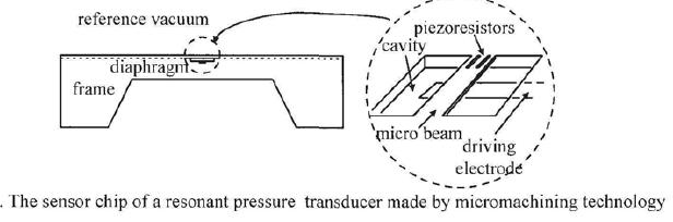

I am trying to model a simple resonant pressure sensor consisting of a rectangular beam suspended in the cavity formed on the top of the diaphragm. Pls refer to the figure in the attachment. Currently I am not so concerned with the beam excitation and want to only check the change in the resonant frequency of the beam with the pressure applied to the bottom of the diaphragm.
Do I need a moving mesh ?
I have tried two approaches.
1. I have taken 2 stress-strain models - one for the diaphragm (static linear mode) and one for the beam(Eigenfrequency mode). But in this case how do I transfer the stresses developed on the diaphragm on to the end face of the beam?
2. The other approach is to define 2 stress strain models as before and a moving mesh for the suspended beam and use the deformed mesh to solve for eigenfrequency. But I'm unable to get the eigen frrequency.
Can anyone give me a detailed procedure to model the sensor?
