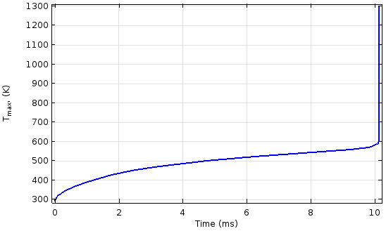

Posted: 9 years ago 24 janv. 2017, 14:17 UTC−5
Antia,
Add Free Tetrahedral node and set Element Size to Finer. After 10 ms temperature is exponentially growing, as shown in the attached image.
Sergei
Antia, Add Free Tetrahedral node and set Element Size to Finer. After 10 ms temperature is exponentially growing, as shown in the attached image. Regards, Sergei
