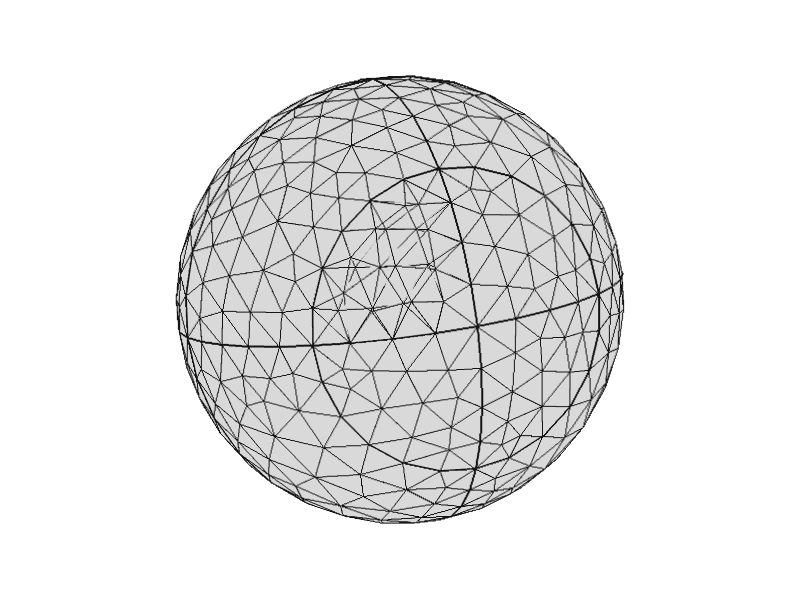

how I created the geometry:
after creating two cylinders and one sphere, I intersected one cylinder one sphere with keeping input objects, so I created middle domains that are created by the intersection. Then I used delete entities to delete the remaining parts of the cylinder.
The result is one sphere with two caps at opposite ends.

my experience is that you should then identify where the mesh issue is and adapt the mesh manually to start to make some local entities with a finer mesh and leave the global "normal" mesh to avoid that you increase the mesh density everywhere.
But mesh density is your discretisation, so once you have solved, you shoul always check the gradients of your solutions, do you have several elements across anny steep gradient ? if not here you shoul densify locally your mesh
