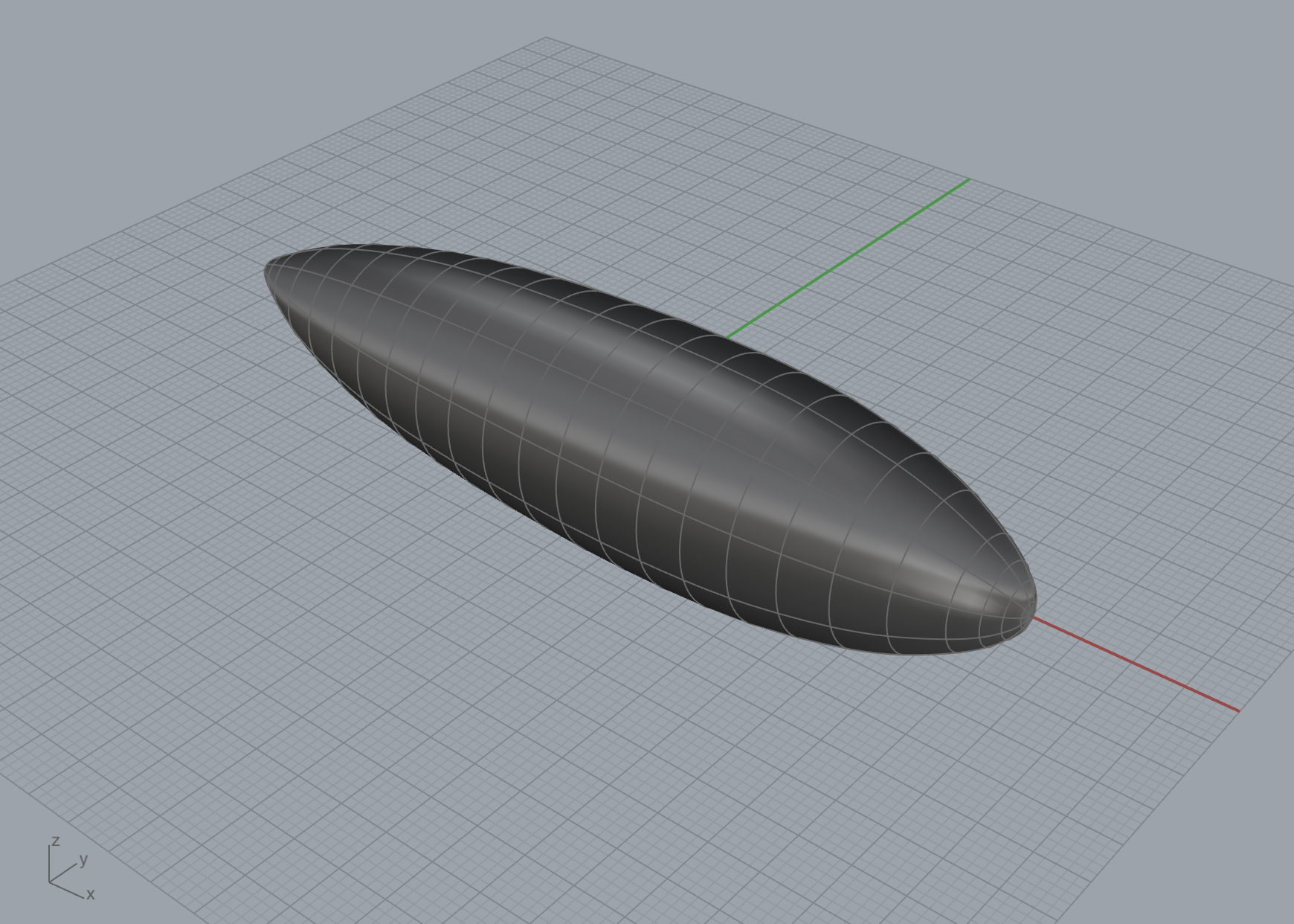

I am performing 3D external flow simulations at high Reynolds numbers (10^6 - 10^8) using RANS turbulence models such as SST. I am trying to validate the turbulence models and mesh with known published data on airship or submarine design (you can see the design of the rotationally symmetrical objects I am using in the .png file).
