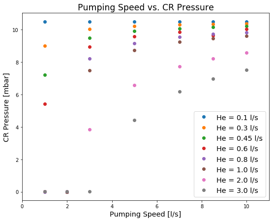

My biggest issue is how to interpret the change in pressure when I change certain parameters. The pressure tends to move in the opposite direction than I would have thought. For instance, when I increase the flow through the top inlet, the average pressure seems to go down. And when I increase the vacuum pump flow rate, the average pressure goes up. I may be misunderstanding something (and likely have something set up incorrectly) but isn't this counter intuitive? Shouldn't the pressure increase if the flow in is higher and the flow out is lower?

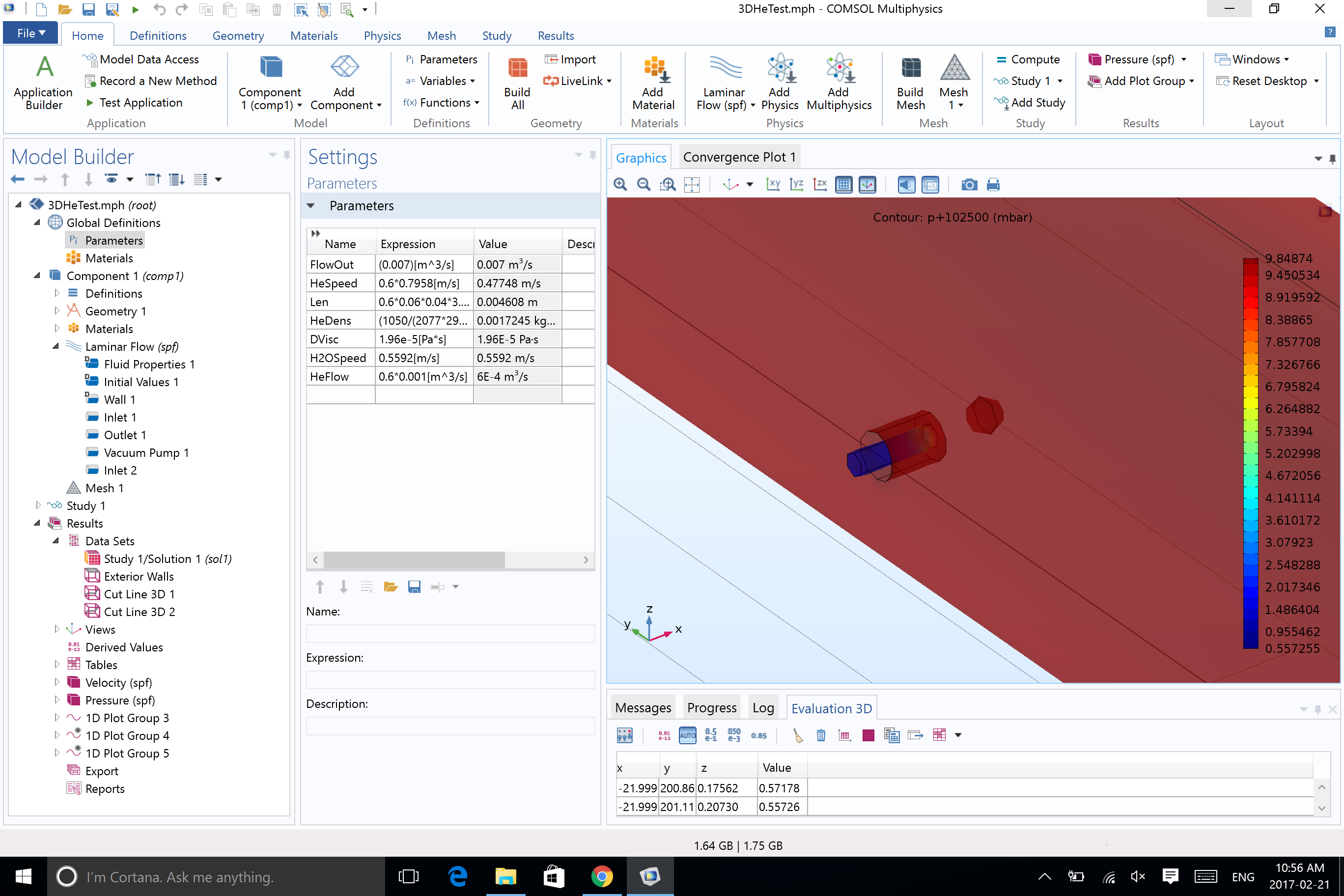

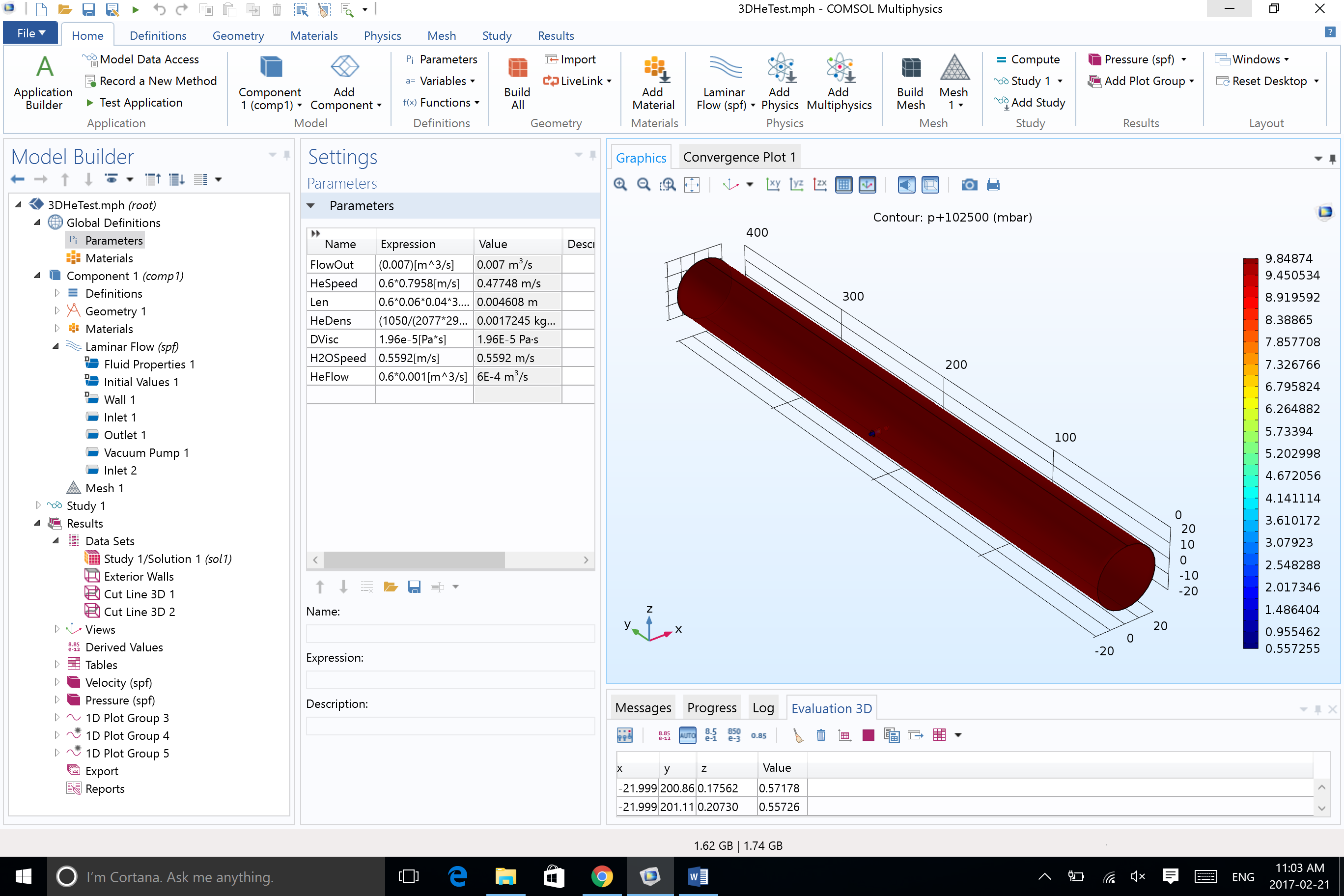

I forgot to add some pictures so I have attached them to this post.

I do believe there is still something wrong with my settings since the trend I am observing does not make any sense. When I increase the flow in through the inlet, the pressure goes down. And when I increase the free delivery flow rate, the pressure goes up.
(I am treating the free delivery flow rate as a variable in order to determine which pump I will need to order)
