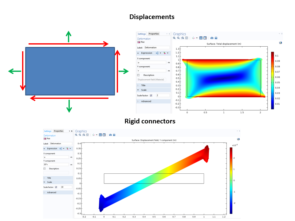

I am trying to simulate a rectangle where I want to apply shear and normal tensions simultaneously. I am trying to do a test where I introduce shear stress and normal stress in both of the principal directions.
First, I have tried with prescribed displacements (x and y directions) on all the edges but in the corners it doesn´t look like it is the best option as it might do strange things in the cornes. (Check the photo attached)
Second, I tried with rigid connectors. If I want only pure shear stress works perfectly. But when I introduce the normal stress in x and y direction (I did it by prescribing a displacement to the center of rotation in the rigid connector node). As it can be checked in the photo it makes also strange things in the corners. I tried also to do a rigid connector plus a prescribed displacement but one overrrides the other.
Is there any chance or any idea of doing it beacause it looks like the problem is in the corner points
