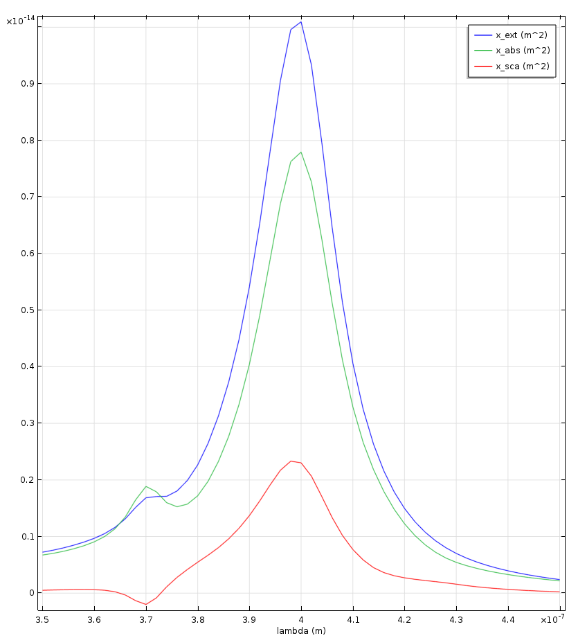

Dear all,
I am trying to use FEM in COMSOL to calculate extinction/absorption/scattering cross section of a ag nanoparticle. I basically followed the process on www.youtube.com/watch?v=8u4pNpf0N2o. However the results I got is much lower than www.orientjchem.org/vol31no4/optical-scattering-and-absorption-characteristics-of-silver-and-silicasilver-coreshell-nanoparticles/
I tried to change mesh and materials but nothing change much. I have attached the plot I get and the mph file. Please let me know what I did wrong and I really appreciate that!
