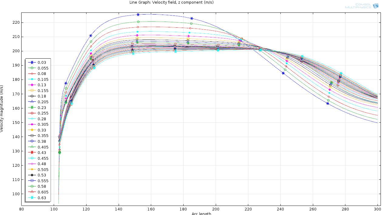

Can the position of the Legends in plot be moved?
I want to display the legends on the plot, but It seems that the Legends are always in the right-up corner of a plot, and sometimes the Legends will overlap part of the data curves. Can the position of the Legends in plot be moved? (I use v4.0)

Does anybody knows if there is a way to have a few more options for the legend position? I.e. right center? My plot has data in all four corners.

not from my knowledge, I'm also miss a middle position, for many of my plots, at least in the height direction ;)

I know it is an old post - but I found a solution/workaround.
Simply make the scale on the X-axis longer. Then the legend will fit and it will not cover any of the data.
