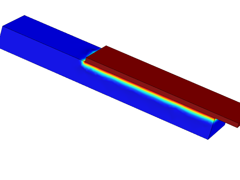

I tried to do what you said but when you run the simulation in different sweeps in parametric sweep it has results for each sweep as default which is not temperature trial. could you please explain how to change parametric sweep and time?
do you mean by this method, COMSOL solves the problem for one step, then if we change the parametric sweep from results (which I could not find how to do it) then COMSOL does the new simulation over the results of previous step and adds the new temperature contour to the last one (which is my goal to achieve :( ).
Is this problem have to be done by this method? can we do this by moving mesh or Deformed Geometry? I tried them both but when the hot box moves it has no changes on the bottom box! and looks like there is no conduction between boxes.

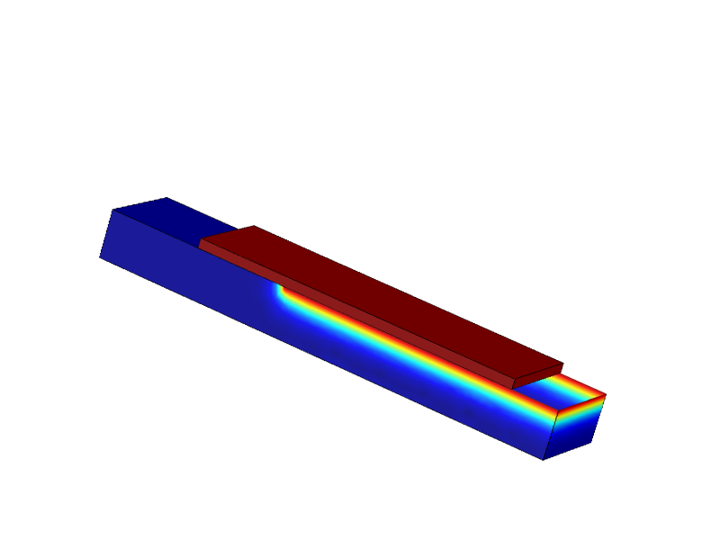

I think I did the same thing but what I have in results is just a box (as my heat source) in 3 positions and in each position it acts for 5 seconds in each case for example from 200 to 300 degree of Celsius. but the other box which is in contact with it under it is effected completely independent of the last step :( . I need the temperature contour on the bottom box to keep the results of each of the three steps :(.
what is wrong with me, I do the same :( but no temperature trial.
maybe I have not said my problem clearly because of my english problem, but I think we had same problem. I have attached a picture please take a look at it. I want the upper box moves along the bottom one and in each step stays about 0.5 second, the box has a constant temperature (which I should change for next step and make it caused to effects from the cold bottom box) . so using the parametric sweep makes independent temperature contour in each step :( even when I change it from results. It looks like we can not add temperature results from previous step to the new step and go through it :(

Why don't you slide the upper bar over the bottom one rather than extending it ?
Try to use a finer mesh and use a more extensive time to be shure it doest not work; even if aluminium is highly conductive, 0.1 sec is quite short to diffuse heat.

thanks for your answers. I used the deformed geometry for sliding too (is that the right way?) and I again had the same problem it was 1 second not 0.1 anyhow I extended to 4 seconds in the tmie dependent range and I again did not see change. so the upper box moves forward but temperature contour is just changes for the first step .:(
I am really confused:(
Gabriel, it looks like as I define the temperature of the upper box it just stays there!! please take a look at the picture!
Gabriel, I think my problem is that conduction between two boxes is not defined. just the common surface between upper and lower box is defined as temperature. so these two boxes had condition between each other then I should had temperature contour in further steps, is there a option to define condition between objects in COMSOL? I have not seen that!
