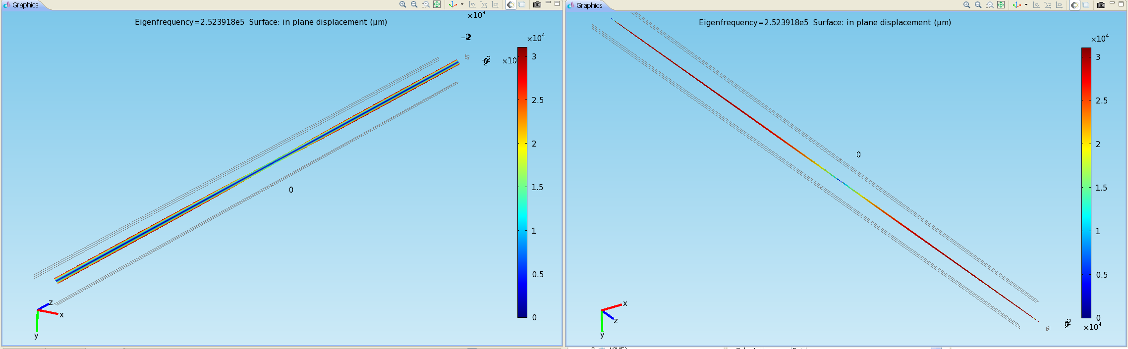

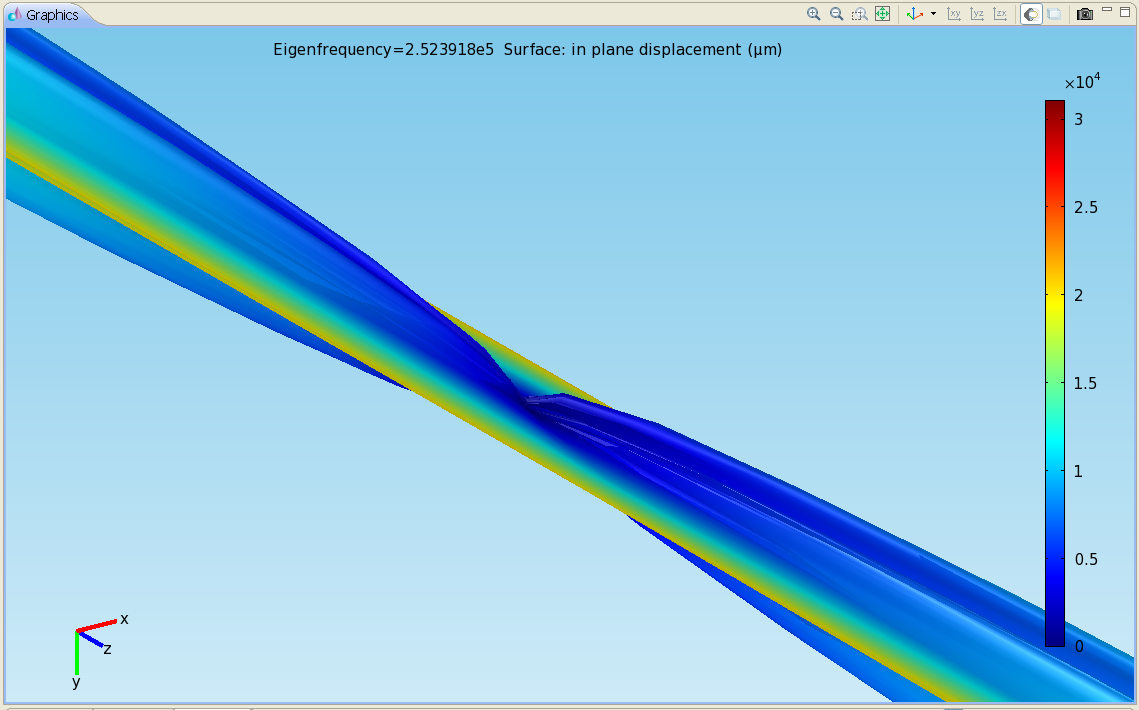

OK hold on, I spoke too soon. What I said for (b) was correct for model "1)", meaning, the 2D version, but not for model "2)", the 3D version. Both models model the same thing as described in my previous post.
Instead, in the 3D model of a thin circular wheel shape fixed near the center, when I switch from Material Frame to Spatial Frame (in Model Builder > Results > Data Sets > Solution 1 > Settings > Frame I see an absolutely gigantic structure that looks like two huge needles (size is 10^4 meters, where my simple disk is 100 um order of magnitude). Problem is I can't decode this strange result because I am not sure exactly what I'm doing when I select Spatial Frame.
But nonetheless I try to calculate circumference using the integral I set up before. And because there's this huge wacky needle thing on my screen of course it gives unintelligible results, pasted below.
Note that I am 100% sure I have drawn nothing else, just a disk that is fixed at the center, and there's no problem with the solver because it finds the eigenmodes just fine.
Here are the "circumference" values for 100 um disk. As you can see, the middle column shows the Material Frame, which is 314. ... um as expected, and the third column shows wacky results from the Spatial Frame.

I wanted to attach images of what I mean when I say "two large needles." I know, this is super weird, I wish I understood what I'm looking at.

Well I'm sorry to hear that you have only 4.0a as that was provided more than a year ago, and you definitively need to get the 4.1 + patches (the latter are on the main web site of COMSOL. Be aware v4.0 was an early version with several weakness
I believe the eigenvalue "participation mass" arrived only in v4.1 (so you would have to live without, for the time being)
Then for the frames, its the opposite: the spatial frame is on by default in V4 and it is the deformed frame. The material frame is the original one of the drawn geometry (by default its plotted as a wire frame on all surface/volume plots. To access the material frame you use upper case letters X,Y,Z and spatial has lower case letters. Your solution is normally in the material frame, so if you do a postprocessing (Results node) integration, you do it on the solution defined frame. While if you define an integration operator in the Definition right click Model coupling you can chose the frame to operate on. You can then use the Results Derived Values Global Evaluation to perform an integration with the previously defined integration operator that will distinguish the two frame values, if you define two operators one on each frame (hope its clear)

Wow! Great tutorial. Yes I didn't understand that "operator" does not mean "quantity," though that should have been clear from the term.
I did your tutorial and also integrated around one of the edges of the cube for both Material and Spatial frames, to make sure I could see a difference, and it worked and the units were correct.
Yet I am still seeing a very strange thing when I try to do the exact same thing on my model (i.e. integrate around an edge to find the perimeter length).
Expected: The integral around the edge for the material frame for a 100um diameter silica disk is 314um as expected.
Unusual: The integral around the edge for my spatial frame (everything else the same as before) is different for each mode, as expected, but the numbers are on the order of 1e7 um! (On the order of ten meters!) I would expect something slightly different to 314um.
Sorry for all the bizarre questions... I really appreciate you helping me with this.
I tried to attach my v4.0a file, but this site said "File size error" -- the file is 6.4 MB which I didn't think was that large, but whatever. So my file is here:
davidnhutch.com/3dDiskMechModes.zip
Note also that I don't think this is related but I am getting Warnings: The relative error is greater than the relative tolerance." I would make my mesh smaller to see if it fixes this but I run out of memory..

There are several threads around the absolute values in the eigenfrequency analysis.
There seem to be easily a misunderstanding in what is coming out of an eigenfrequency analysis!.
An eigenmode analysis is giving frequencies and mode shapes, but there is nothing in the mathematical steps that defines a given energy in and out. Normally the amplitude at a resonance tend to INF. So you cannot expect to get any useful absolute results out, if you do not apply some specific normalisation and add a few assumptions.
COMSOL has selected one particular norm for the eigenfrequency shapes, many other FEM programmes use other norms.
In v4.1, COMSOL its improved, and you are allow too to select:
Use the Scaling of eigenvectors list to specify the scaling method used to normalize the eigenvectors:
• Select RMS to use root mean square (RMS) normalization.
• Select Max to use max norm normalization.
• Select Mass matrix to scale the eigenvectors such that the modal masses become unity. If this scaling method is used the Participation factor field list appears. Select the field for which to compute the mass participation factors (typically a displacement field such as mod1_u).
I prefer the last one, as thes quare of the mass participation factors mod1_u,v,w should add up to the total mass of the object along the three directions (if all modes are included) this allows to tell which modes have which influence along the three dependent directions and which can be ignored. Is stll missing in v4.1 the rotational modes participation factors, adding up to the inertias of the object.
In any case none of the norms give any absolute displacements, as a) as already said there is no energy limit in, and b) no damping is considered hence energy loss that participates to limit the total amplitudes
In 3.5 you must extract the deformations of the modes and renormalise them by hand, still possible for simple cases, such to to calculate the participation masses (I gave up as my models are mostly so heavy that I cannot even extract the modes shapes without variable size overruns in matlab)
The warnings (you get less in v4.1) are related to non-optimum solver settings, tolerances and mesh sizes, a nice mix of all three ;) I'm still searching for "the" way to improve them myself
