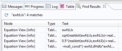

The fastest way of finding a variable is to search for it by Ctrl-F. In the results from the search you can double-click any row, and get automatically redirected to the corresponding reference in Equation View.
See the attached screenshots.

Thank you very much! For future reference, I was able to find the required variable definitions in the "Equation view" node of the "Wave equation" node (not the Physics interface node)
