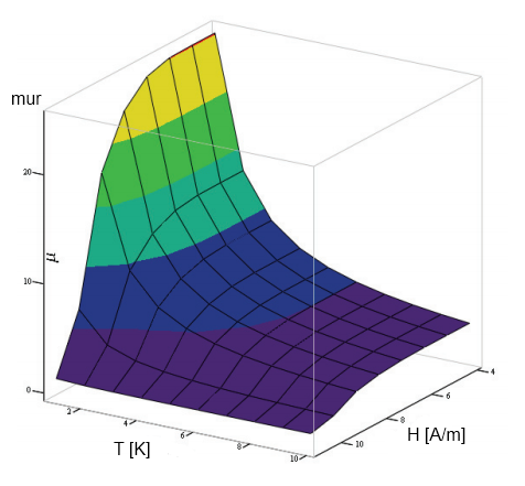

Hello!
You don't understand my question. I want to solve thermo-magnetic problem. Relative permeability (mur) in each piece of solid body depends on two arguments - temperature (T, [K]) and magnetic field (H, [A/m]). How can I input that dependence (3D surface show on picture in attachment) in table data? We have all data, but don't know how and where input this data.
Thanks.
Hello! You don't understand my question. I want to solve thermo-magnetic problem. Relative permeability (mur) in each piece of solid body depends on two arguments - temperature (T, [K]) and magnetic field (H, [A/m]). How can I input that dependence (3D surface show on picture in attachment) in table data? We have all data, but don't know how and where input this data. Thanks.

Indeed I did not ;) well in both 3.5 and 4 you need to add an interpolated function based on table grid (or an analytical function of that is possible) , Either as a specific material or as a function and referring to that material domain in the physics settings
the COMSOL Multiphysics Definitions Functions help section gives more detail (as well as the doc v4.1, similar for 3.5)
I could not find any examples in the material library of materials set up with two variables and a interpolation table, only two variables linked by an analytical function. Anyhow looking at the material database (i.e. gases) is a good way to learn
Hi Indeed I did not ;) well in both 3.5 and 4 you need to add an interpolated function based on table grid (or an analytical function of that is possible) , Either as a specific material or as a function and referring to that material domain in the physics settings the COMSOL Multiphysics Definitions Functions help section gives more detail (as well as the doc v4.1, similar for 3.5) I could not find any examples in the material library of materials set up with two variables and a interpolation table, only two variables linked by an analytical function. Anyhow looking at the material database (i.e. gases) is a good way to learn -- Good luck Ivar

Indeed this is how I would start, as youre function Cp(T,H) is not dependent on any space coordinates I would leave the tick off. Check the doc to get the order / mapping correct (I too need to reread and exercice it each time I use it)
Normally you can then use your function with two scalar variables (other than x,y)
Hi Indeed this is how I would start, as youre function Cp(T,H) is not dependent on any space coordinates I would leave the tick off. Check the doc to get the order / mapping correct (I too need to reread and exercice it each time I use it) Normally you can then use your function with two scalar variables (other than x,y) -- Good luck Ivar
