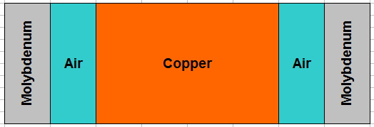

problem with heat simulating in terms of air heating
hi

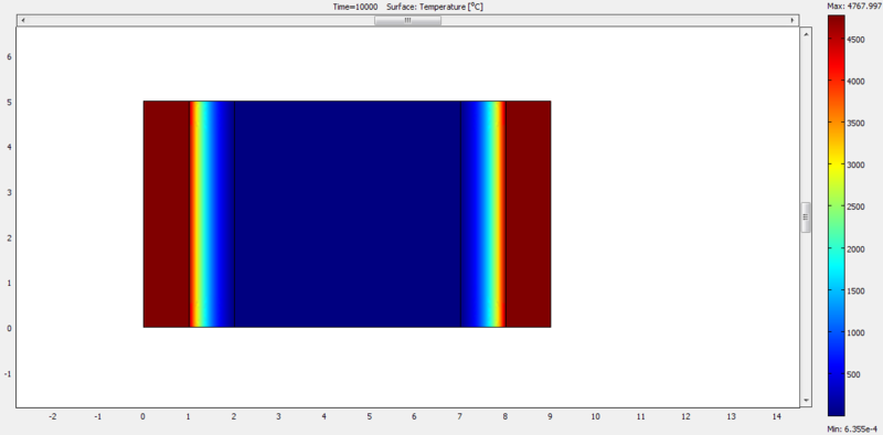

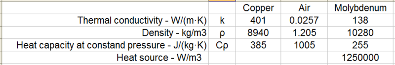

i am simulating the heat process
i have enclosed 3 pics for better explanation
it seems that the air section should have another results
Please let me know if my concern is correct
thx

your explanations are a bit shoret to allow us out here to fully understand.
Have you checked the power balance in/ out ? in your model.
And temperatures are in Kelvin in COMSOL, it's rather easy to mistype a 20[degC] by just "20" and then you have 20[K] by default as value ...
Hi your explanations are a bit shoret to allow us out here to fully understand. Have you checked the power balance in/ out ? in your model. And temperatures are in Kelvin in COMSOL, it's rather easy to mistype a 20[degC] by just "20" and then you have 20[K] by default as value ... -- Good luck Ivar

Hi Ivar
thank you for your reply
Could you please be more specific?
I have double checked - it is correct. all temp values are in Kelvin
Does it make sense use Heat flux instead of air block?
Hi Ivar thank you for your reply [QUOTE] Have you checked the power balance in/ out ? in your model. [/QUOTE] Could you please be more specific? [QUOTE] And temperatures are in Kelvin in COMSOL, it's rather easy to mistype a 20[degC] by just "20" and then you have 20[K] by default as value ... [/QUOTE] I have double checked - it is correct. all temp values are in Kelvin Does it make sense use Heat flux instead of air block?

I "always" do a few model verification such as integrating the fluxes I have defined as enetering and exiting my models.
As there should be energy conservation in there, it's often worth to check that the fluxes sum up, you can do this by integrating the different heat fluxes over the external boundaries
Hi I "always" do a few model verification such as integrating the fluxes I have defined as enetering and exiting my models. As there should be energy conservation in there, it's often worth to check that the fluxes sum up, you can do this by integrating the different heat fluxes over the external boundaries -- Good luck Ivar
