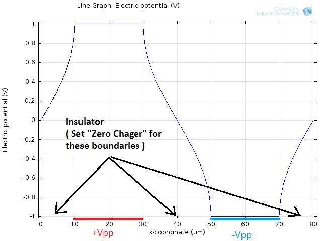

                                                    Hi all
I'm working with Electrostatic Module, but when I get the 1D - Line plot for Electrical Potential distribution a long x-axis ( x=from 0 to 80 um, y=0 ), the plot likes " potential.pgn" image.
I just think that in the boundaries set by Zero Charge ( that means " Insulation boundaries ), the potential is totally "Zero", but in my case, this figure is not Zero, it seem to be slight decrease.
Does anyone help to to clear my problem ? Thanks in advanced
