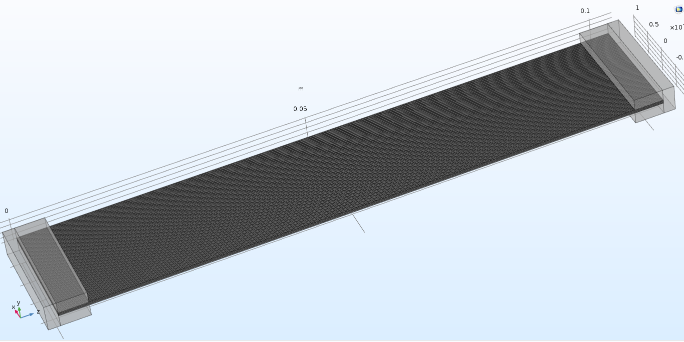

I am trying to mesh CFRP and copper material, but there is so much size difference that i am unable to do it. any help?
3 Replies Last Post 23 mai 2017, 17:13 UTC+2
Posted: 8 years ago 23 mai 2017, 00:16 UTC+2
Updated: 8 years ago 23 mai 2017, 00:17 UTC+2
I suggest a swept mesh (along the z direction) for the slabs.
Amin,
[QUOTE] I am trying to mesh CFRP and copper material, but there is so much size difference that i am unable to do it. any help? [/QUOTE] I suggest a swept mesh (along the z direction) for the slabs. Amin,

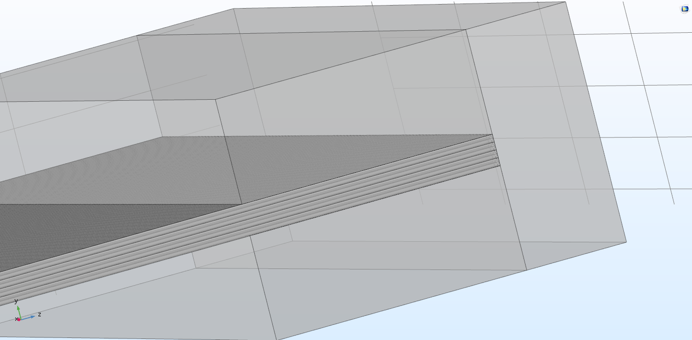

I am new to COSOL (or any other 3D software), can you tell me in detail how to do that?
The maximum dimensions is 5 mm and minimum is 0.075 mm.
Prashant
I am new to COSOL (or any other 3D software), can you tell me in detail how to do that? The maximum dimensions is 5 mm and minimum is 0.075 mm. Thanks Prashant
