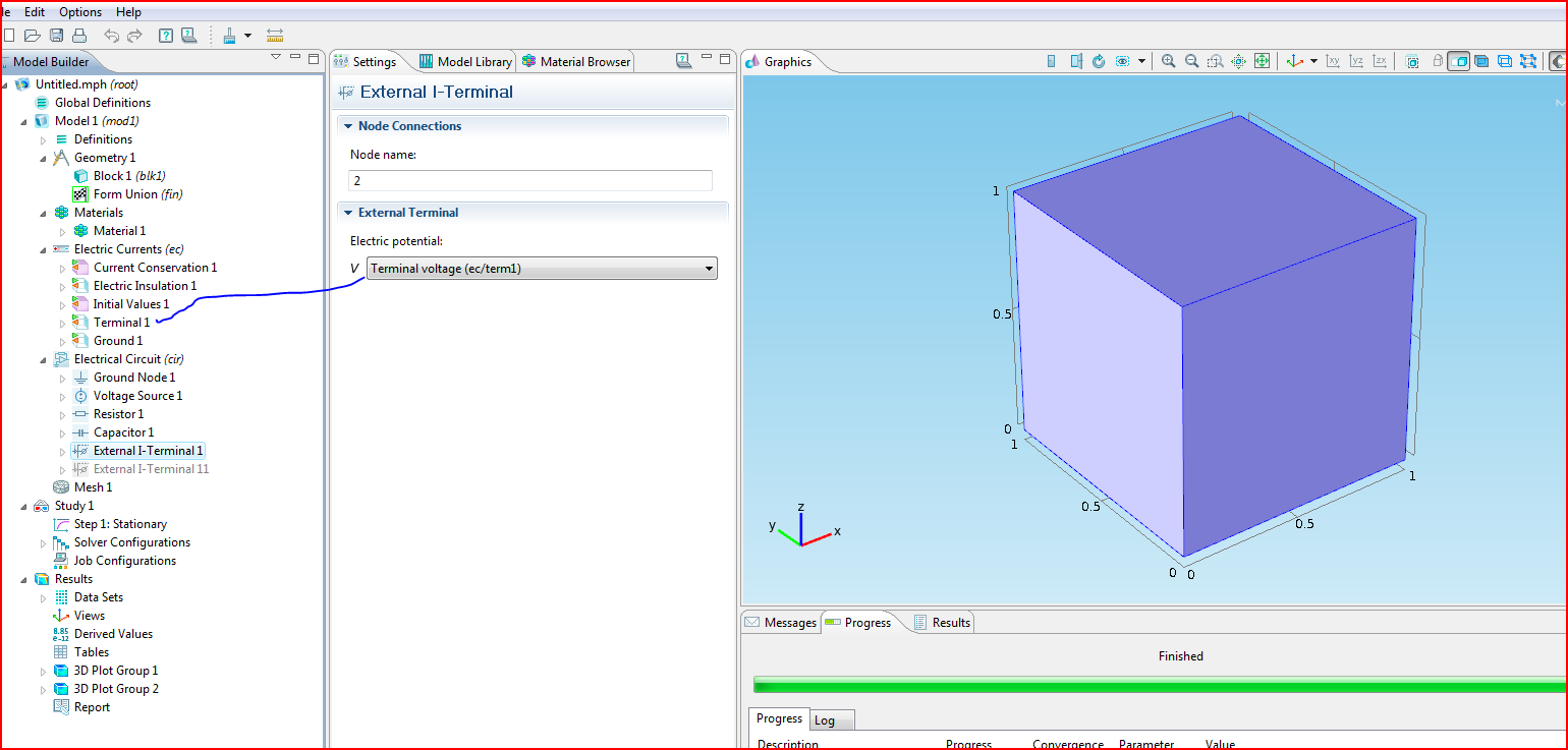

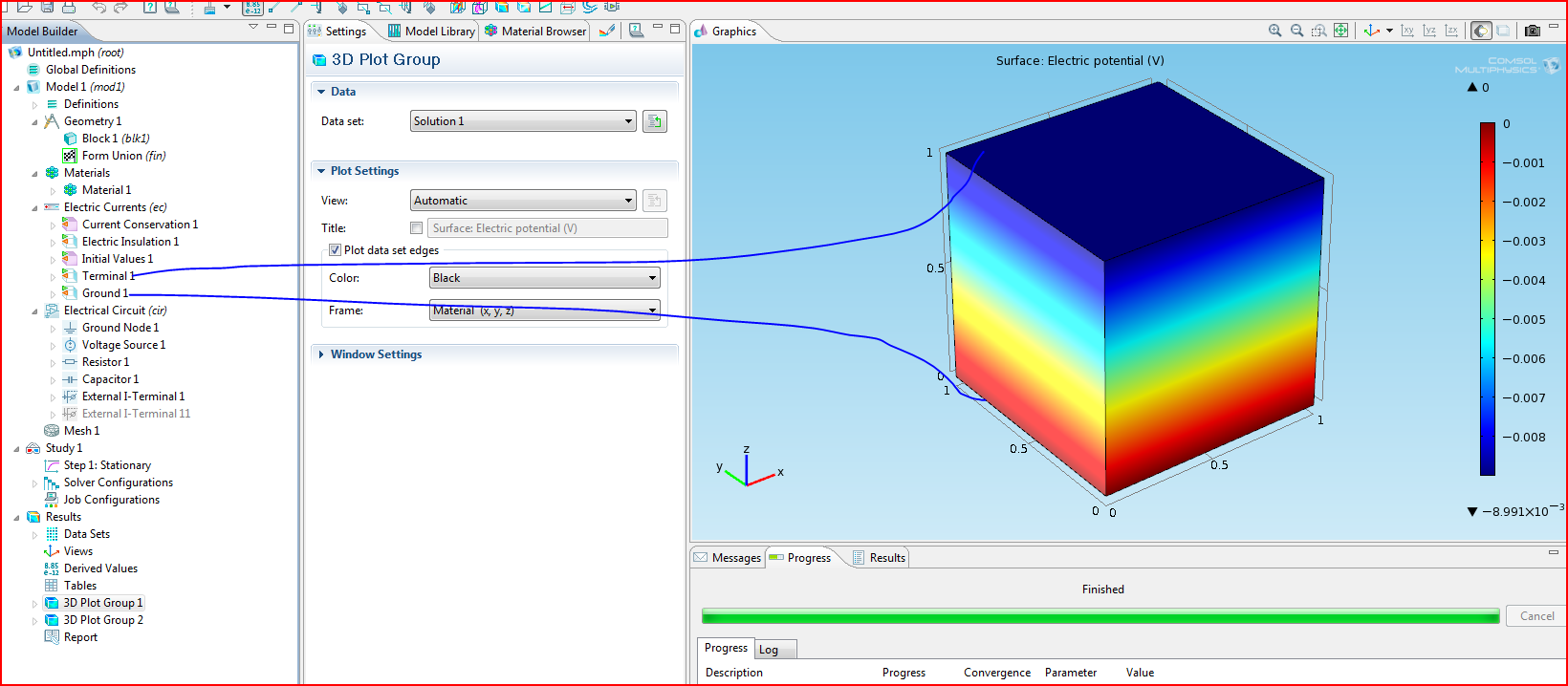

This is quite easy to do but it is somewhat different than in version 3.5a. First you can just save your netlist as a text file (ascii) but with the extension ".cir" e.g. mynetlist.cir.
* Then in COMSOL, create your 3D model using the Electric Currents physics interface (under AC/DC), add also the Electrical Circuits interface (AC/DC).
* Create a block.
* Add a suitable material to the block.
* In the Electric Currents Interface, add a Terminal Feature and set its Terminal type to Circuit and select one face.
* Add Ground feature and select the opposite face.
* Right-click the Electrical Circuits node and select Import Spice Netlist, browse to your .cir file and import.
* Now, you will get the desired feature set under the Electrical Circuits node. There will be two External I-Terminals but as one of them is for the ground end of the finite element model (and circuit) , it will not be needed so disable that one.
* For the remaining External I-Terminal, set the Electric potential to Terminal voltage (ec/term1), i.e. connect it to the Electric currents Terminal.
* Solve the model!
See also the attached screen dumps for guidance.

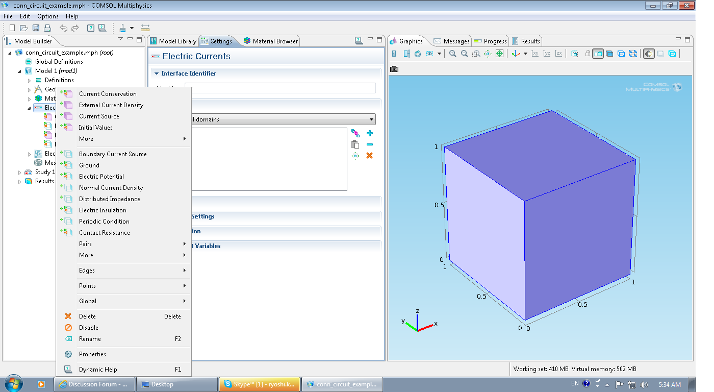

Dear Mr. Olsson,
I followed the steps of your example, but there is no Terminal feature in my EC interface. I am using comsol 4.1.0.88. Could you please look at the screenshot and advise me what is wrong. Is my version of comsol missing something?
Is there a workaround? I would appreciate your help very much.
Victor
Dear Mr. Olsson, I followed the steps of your example, but there is no Terminal feature in my EC interface. I am using comsol 4.1.0.88. Could you please look at the screenshot and advise me what is wrong. Is my version of comsol missing something? Is there a workaround? I would appreciate your help very much. Victor
Posted: 1 decade ago 29 nov. 2011, 01:39 UTC−5
that is strange, which "physics in ACDC ? the "EC" ?
By the way it is absolutely worth to upgrade your version, v4.2 is far more stable than the earlier V4 versions (still v4.1 was quite good)
Hi that is strange, which "physics in ACDC ? the "EC" ? By the way it is absolutely worth to upgrade your version, v4.2 is far more stable than the earlier V4 versions (still v4.1 was quite good) -- Good luck Ivar

I hope it's not too late. You might want to couple as follows:
Electrical Circuit (cir) to Electric Currents (ec) to Thermoelectric effect.
I believe this is what you want. In the electrical circuit physics, you can import the SPICE stuff. With this you can connect to electric currents via External I-Terminal. This means that your physics is now present in the 3D model you are working in.
Hope this helps!
