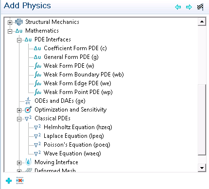

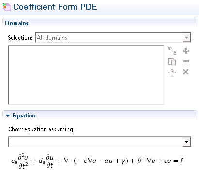

Check the list of Math physics, basically the PDE of the coefficient form entering the shape given hereafter are solved, so long we talk about well defined BVP. The all terms might be analytical functions not just constants, which often leads to non linear problems. Higher order equations must be preprocessed manually to get down to 2nd order by a adding a few new intermediate variables.
Check with your local rep to follow one of the training courses, or the free workshops
Hi Check the list of Math physics, basically the PDE of the coefficient form entering the shape given hereafter are solved, so long we talk about well defined BVP. The all terms might be analytical functions not just constants, which often leads to non linear problems. Higher order equations must be preprocessed manually to get down to 2nd order by a adding a few new intermediate variables. Check with your local rep to follow one of the training courses, or the free workshops -- Good luck Ivar
