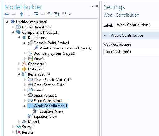

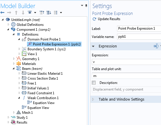

I am working on the steady-state vibration of a simple 2D cantilevered beam. My question is like in other software we can apply load on a mesh when the model is a simple line segment. But it seems to me that Comsol only allows me to apply a point load to the boundary points. I know i can divide the line into different segments in geometry and that way get point. But is there any way i can rather apply the load on the mesh? In simple sentence, is there anyway for user to perform any operation which will make these mesh to be also recognized as points?
