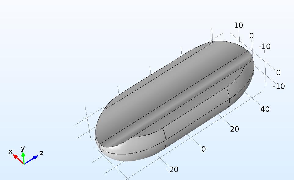

I am new to Comsol, and I am now dealing with the stimulation of the Scattering/Absorption/Extinction cross-section of a Gold Nanorod concave structure(Fig.1). My work is based on the APPs: Scattering nanosphere & scatterer on substract.

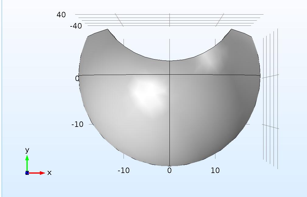

to make sure the normal vector is outward. But my structure has a Concave inner surface, so the situation can be complicated.
1. Does the vector (nx,ny,nz) just mean the outward normal vector?
2. How to define the ofact sign function of the complicated structure?
nx*x+ny*y+nz*z>0 for some parts of the concave inner surface, while the others <0. (Fig.2)

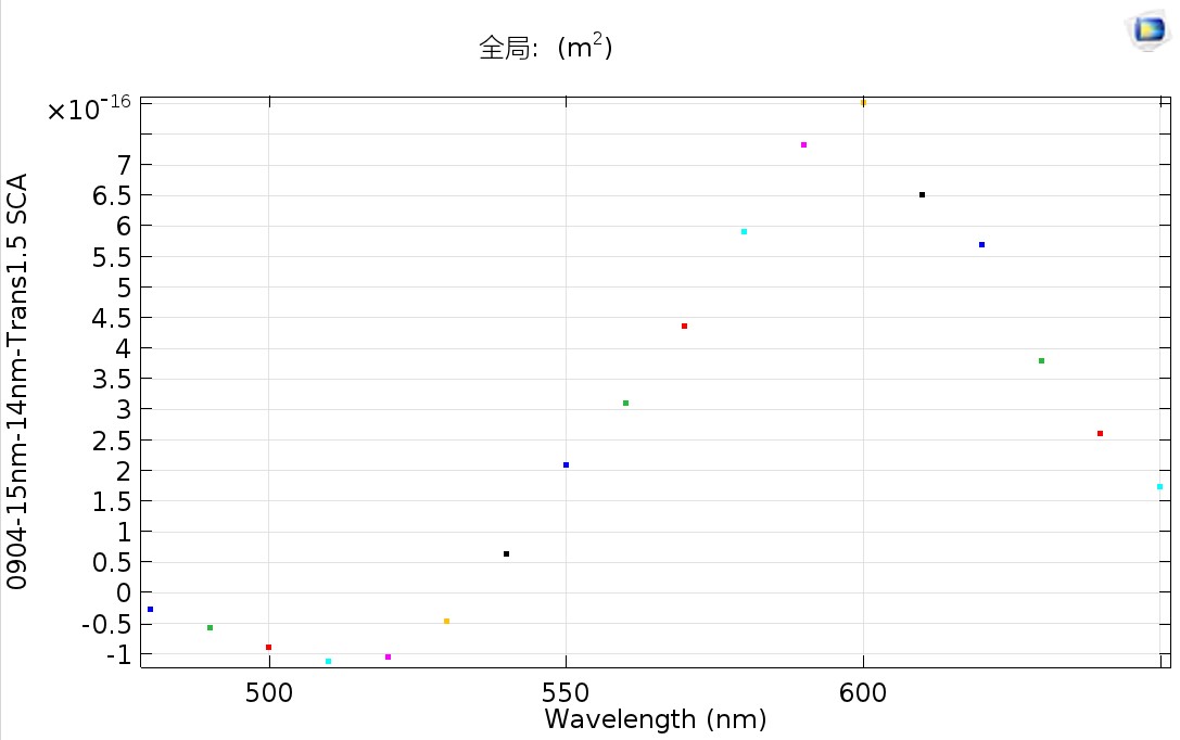

3. While I define ofact=if(nx*x+ny*y+nz*z>=0,1,-1), the scattering value sometimes be negative, does a negative value of scattering corss-section meaningful? (Fig.3)
4. While I define ofact=1; The scattering value could be so low compared with the Absorption value, is it right?
