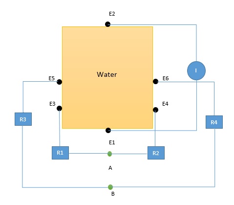

I am comparatively new at COMSOL. I am trying to simulate two part of my problem.
1) Two electrode for current carrying
2) Other each of four electrode attached with external resistor. Two of them will shorted. Other two will also shorted. I want to measure the potential between resultant two nodes.
The set up can be better understood from my schematic that i have attached.
I have used terminal 1 and ground feature for current carrying. And other four terminal for voltage measurement. I also have attached four terminal with external I vs U. But i cant find the solution. Shows error in performing the simulation.
Reason may be terminal are not connected with external I vs U. Or node connection.
Any help will be highly appreciated
