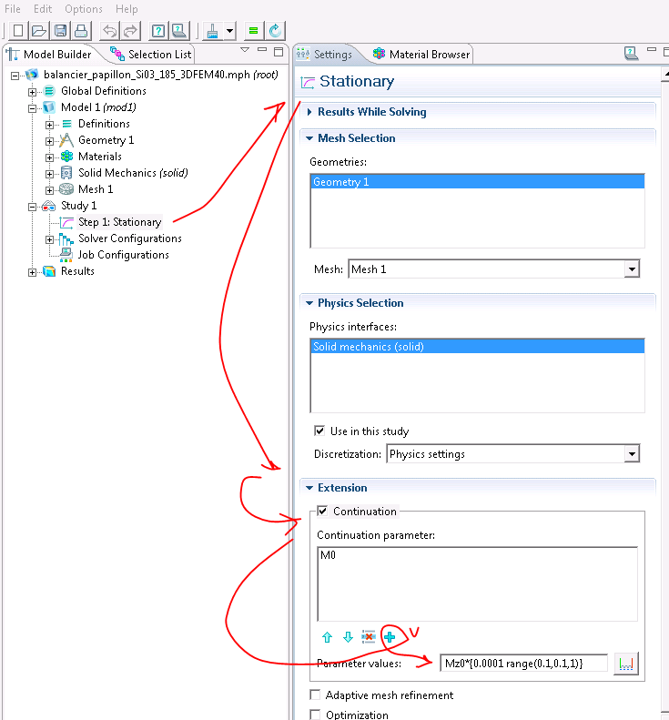

Posted: 1 decade ago 16 mars 2011, 22:17 UTC+1
I would say so, take a look this is for a torque load applied in steps
Hi I would say so, take a look this is for a torque load applied in steps -- Good luck Ivar
