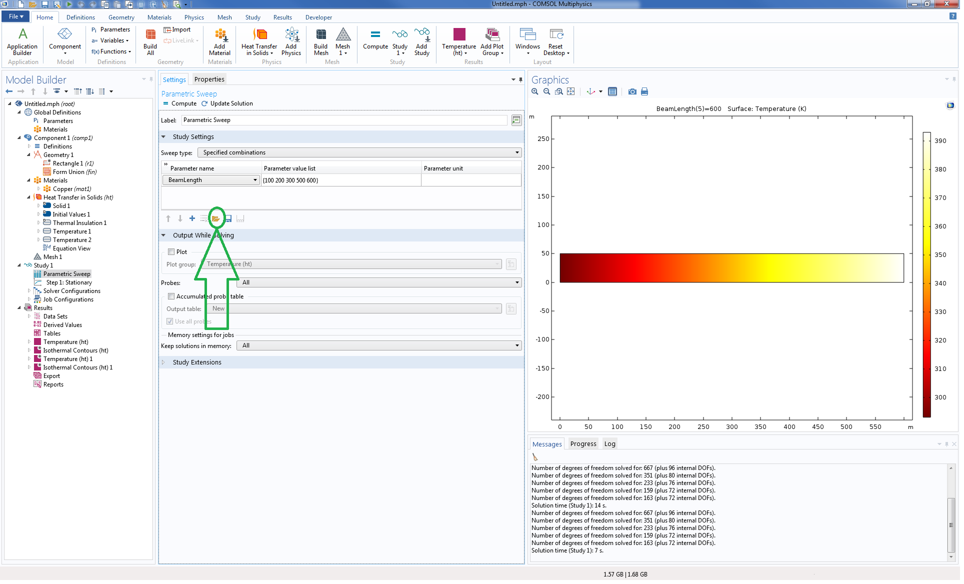

Hello Vineet,
You use the "Load from File" icon located on the Parametric Sweep window, then browse to the text format file containing the parameter names and values. See the attached files for an example.
Hello Vineet, You use the "Load from File" icon located on the Parametric Sweep window, then browse to the text format file containing the parameter names and values. See the attached files for an example. Best, Jeff
