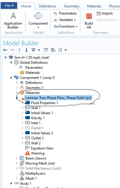

Hi, I hope someone more expert than me could help me. I want to open an old file (Comsol 4.2) into Comsol 5.3 but some physics such as (Two phase laminar flow) are changed and so the program give me a "warning". I want to use the new interface. There is a simply way to do this or I have to remake it in new comsol?

if you have other versions in between 4.2 and 5.3 installed then do a leapfrog and move on from version to version. Otherwise you can export your 4.2 model into java code and then edit the code until it works. This way you may not need to build the whole thing again. However, it might be the fastest way to just build a new model in 5.3.

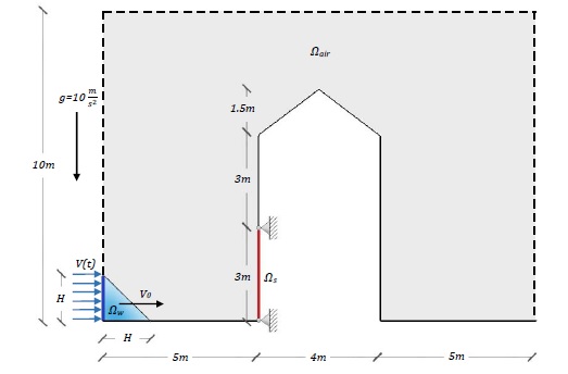

Thanks. When I open the file in 5.3 it works. The problem is that I want replace the old phisics (Two phase flow) with the new. When I try do rebuild model it doesnt't work. Specially when I introduce velocity condition becouse under gravity water collapse! Before it worken in 5.3 no. Why? You have some idea? Please help me :(
