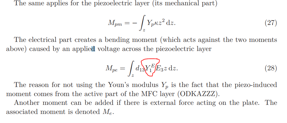

Thanks for your response. We are checking the deflection of piezoelectric bimorph layer with substrate material of ABS and PZT-5A as piezolectric. We are taking reference of a thesis by Marek Hudec which I have attached here and also the shared link. According to him the canteliver deflection is inversely proportional to its width but the same modelling in comsol is not giving the required deflection relation. I have attached the image in which he have used Y1(youngs modulus of MFC at constant electric field) instead of using the Youngs modulus of MFC. Can you please tell me which Youngs modulus should be taken in calculations and what is the relation of the deflection with width of the canteliver. Kindly have a close look at the moment integral due to piezoelectric properties mentioned in the thesis.

Thanks for your response. We are checking the deflection of piezoelectric bimorph layer with substrate material of ABS and PZT-5A as piezolectric. We are taking reference of a thesis by Marek Hudec which I have attached here and also the shared link. According to him the canteliver deflection is inversely proportional to its width but the same modelling in comsol is not giving the required deflection relation. I have attached the image in which he have used Y1(youngs modulus of MFC at constant electric field) instead of using the Youngs modulus of MFC. Can you please tell me which Youngs modulus should be taken in calculations and what is the relation of the deflection with width of the canteliver. Kindly have a close look at the moment integral due to piezoelectric properties mentioned in the thesis. [https://drive.google.com/open?id=1M_wXDpNHcrQQWK1irsyENCAkvwbjI2pZ](http://)

This is a vastly different and more complex question than the one you originally posed.
Perhaps this will be read by someone who is familiar with that specific document and who can help you out.
