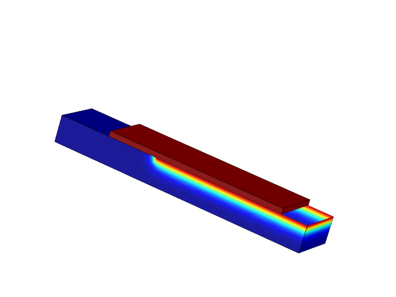

I am doing a heat conduction analysis in 3D. what I need to do is to move or slide a hot box over another cold box from head to tail. so as the hot box(upper one) is going over the bottom one there should be a time dependent temperature contour in in the bottom one. I have tried deformed geometry and moving mesh (where I see no temperature sense in the bottom box as the upper one moves forward after one step) and also although I do not want to use parametric sweep it is again does not answer to my problem. please take a look at the attached picture and see how the temperature contour is not correctly distributed as the upper box slides :((
Please help me with your comments. I am worried if is this thing doable in COMSOL?

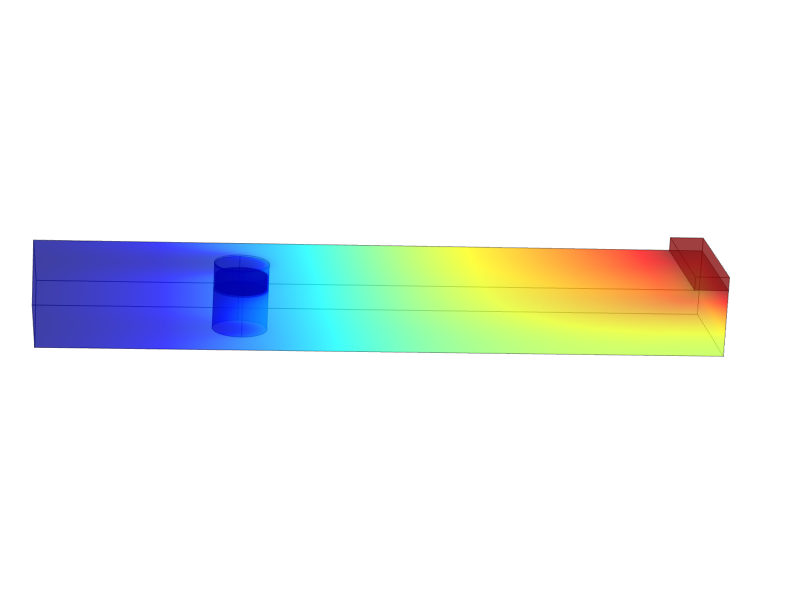

I wanted to say I can not use HT in solids. in my problem I have a vertical cylindrical hole in the bottom block say in location x and is filled with another material something like discontinuity in bottom box. so if the heat wants to transfer in bottom box from right to left then it will not be same situation for the temperature contours after the hole.
and also in the contact surface in bottom block we should have the same temperature as upper box but as you see in figure, I have defined motion in x direction 0.0025 m/s and the length is 5 cm so when time is 20 sec all the top surface should be somehow red but it is still blue :(
and the main problem is th temperature distribution after the hole as you see is not simulating real contours as hot box moves.
please take a look at pic and file. thank you so much Ivar
