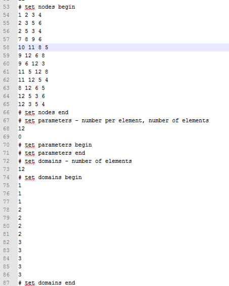

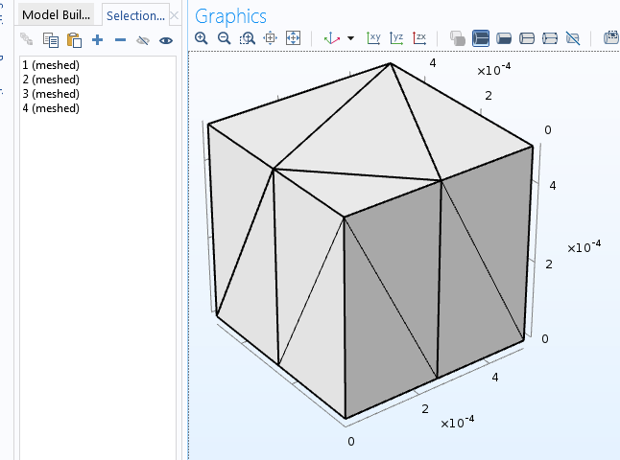

I create a mphtxt file which has 3 domains from external software but when I import this mphtxt file to COMSOL, I get 4 domains in the selection lists.

In the mesh file that you have attached, domain 2 consists of two connected parts. It is defined as follows:
7 8 9 6 # tetrahedron 4
10 11 8 5 # tetrahedron 5
9 12 6 8 # tetrahedron 6
9 6 12 3 # tetrahedron 7
Tetrahedra 4, 5 and 7 are connected to each other, while tetrahedron 5 is not connected to the others. Hence, Comsol splits domain 2 into two domains, assigning the unconnected tetrahedron 5 to a new domain.
We understand that this might be a problem if you want to use your original domain 2 in e.g. a physics interface. Then you need to select both domain 2 and domain 4. Which is not that complicated in this simple case, but could be hard in a complicated case where the original domain would be split into many domains.
In Comsol Multyphysics 5.3a, there is a possibility to import selections via mesh files. I have attached an edited version of your file to show you an example. The selection is defined by the following lines at the end of the file:
