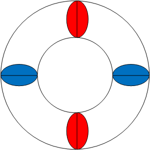

I am currently trying to model a permanent magnet which has multiple poles. In the image an example is shown.
How do I need to model this?

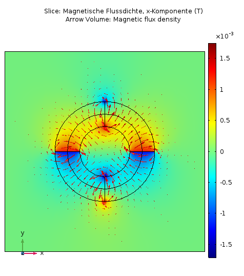

I was able to model a magnet with only two poles. For this I took a zylindrical geometry and megnatized it. My attempt for multiple poles was, that I cut the zylindrical sphere into multiple parts and magnetized these separate parts. Unfortunatly this resulted in the same as if I had not cut it. Attached is my attempt.
