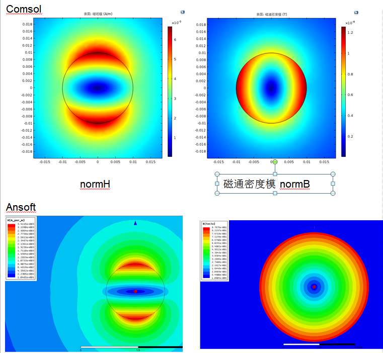

I want to simulate a simple model of a copper wire with dc current, and I want to look how the magnetic field looks like in the wire when the perneability is anisotropic such as mu_x=1; mu_y=2; mu_z=1. The model I used was 2D with a small circle for the cross section of the wire and a much bigger circle for the air section. The results seems odd because the B seems like anisotropic(an ellipse) while the H is also anisotropic.
And I tried to do the same thing in Ansoft and it turned out different results: The H is still anisotropic but B is isotropic (a perfect circle in other words).
I think there should be only one correct result if all the modeling steps were the same, so which one is wrong?

Thank you for your reply, it makes sense that anisotropic permeability results in anisotropic fields, but should both the fields B and H (normB and normH in comsol) be anisotropic?
Meanwhile, I can not understand why the results of Comsol and Ansoft are different, there must be one wrong.
I added my results as a picture below my post.
Thanks again
