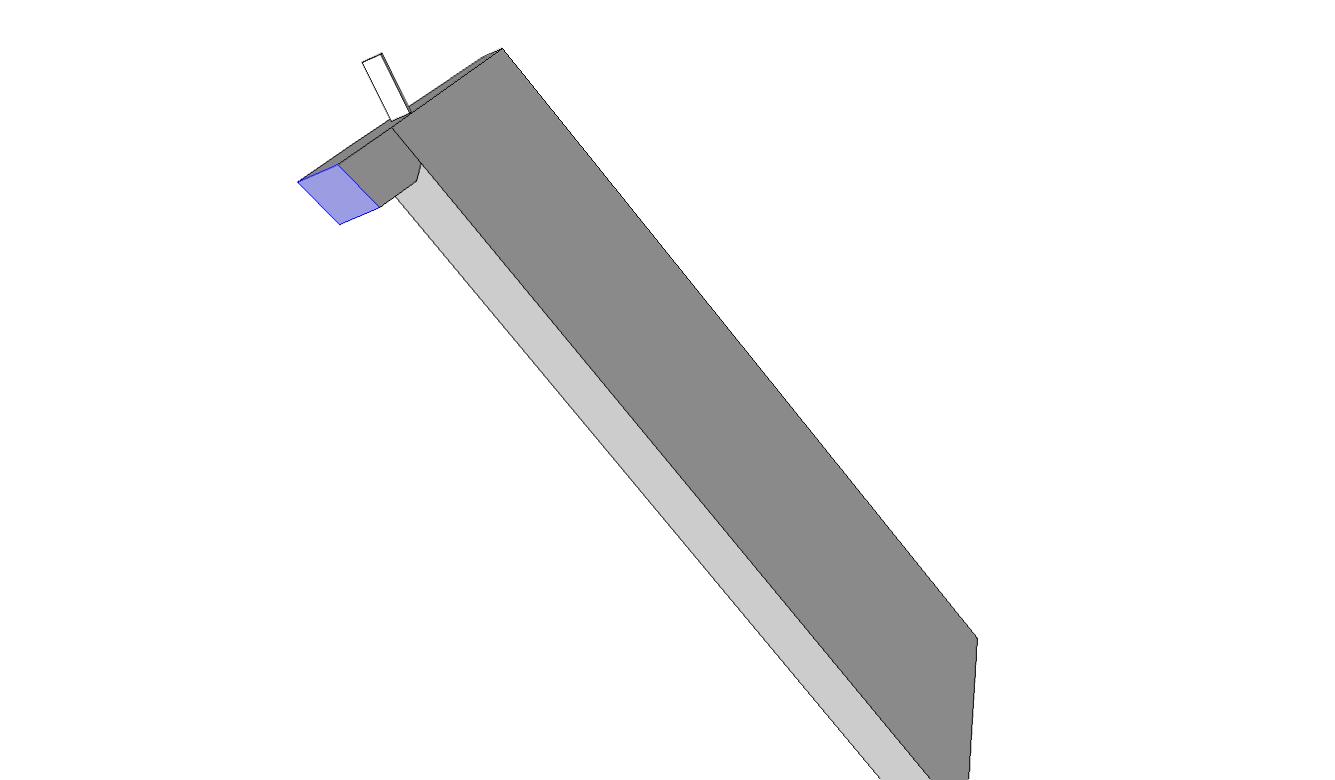

I am trying to make a face partition on a geometry in order to create a boundary condition, but I am struggling to get this done in COMSOL. Please find attached for a picture of my model showing the face I want to partition into two. I have also attached a .mph file of the model. A valuable help and guide will be well appreciated.

you will need to add a feature that is suited to partition the face. This can be a workplane in case the cut has to be a straight line.
Cheers Edgar
