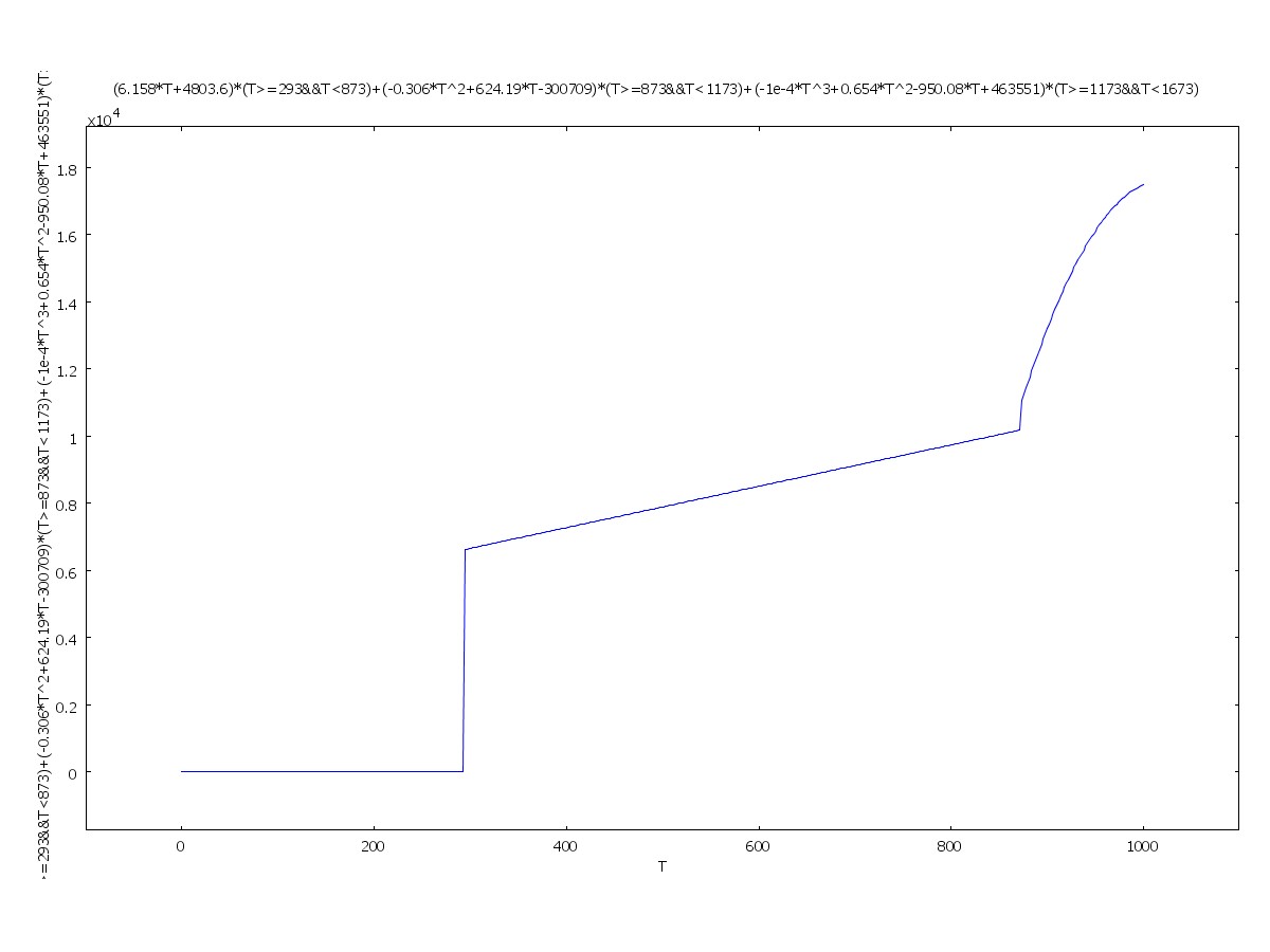

i work on COMSOL 3.5a and 3.5 to make a model with heat transfer and i need to introduce thermal properties of material which change with temperature (exp: K(T)), in scalar expression i should enter the equation of K(T) :
K(T)=(6.158*T+4803.6)*(T>=293&T<873)+(-0.306*T^2+624.19*T-300709)*(T>=873&T<1173)+(-1e-4*T^3+0.654*T^2-950.08*T+463551)*(T>=1173&T<1673)
i specify that K takes different values for 293<T<873 , 873<T<1173 , 1173<T<1673
i need your help to check if my expression of K is correct or not
thank's all
