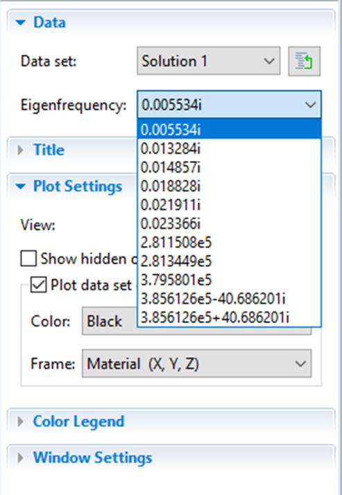

Hi, Thank you very much, that does resolve lot of queries. I still have one. I am getting a modal frequency with same real and imaginary values but it is shown with different sign. PFA image (Last two frequencies)
The mode shape for both of them is same. Why is that?
Hi, Thank you very much, that does resolve lot of queries. I still have one. I am getting a modal frequency with same real and imaginary values but it is shown with different sign. PFA image (Last two frequencies) The mode shape for both of them is same. Why is that?

Hi Ganesh,
The complex conjugate pair is probably numerical noise. Note that the imaginary part is small relative to the real part. If you have a good value for Search for eigenfrequencies around (like 2e5), and still get this behavior, I would suggest tightening the Relative tolerance in the Eigenvalue Solver node.
Henrik
Henrik Sönnerlind
COMSOL
Hi Ganesh, The complex conjugate pair is probably numerical noise. Note that the imaginary part is small relative to the real part. If you have a good value for **Search for eigenfrequencies around** (like 2e5), and still get this behavior, I would suggest tightening the **Relative tolerance** in the **Eigenvalue Solver** node. Regards, Henrik
