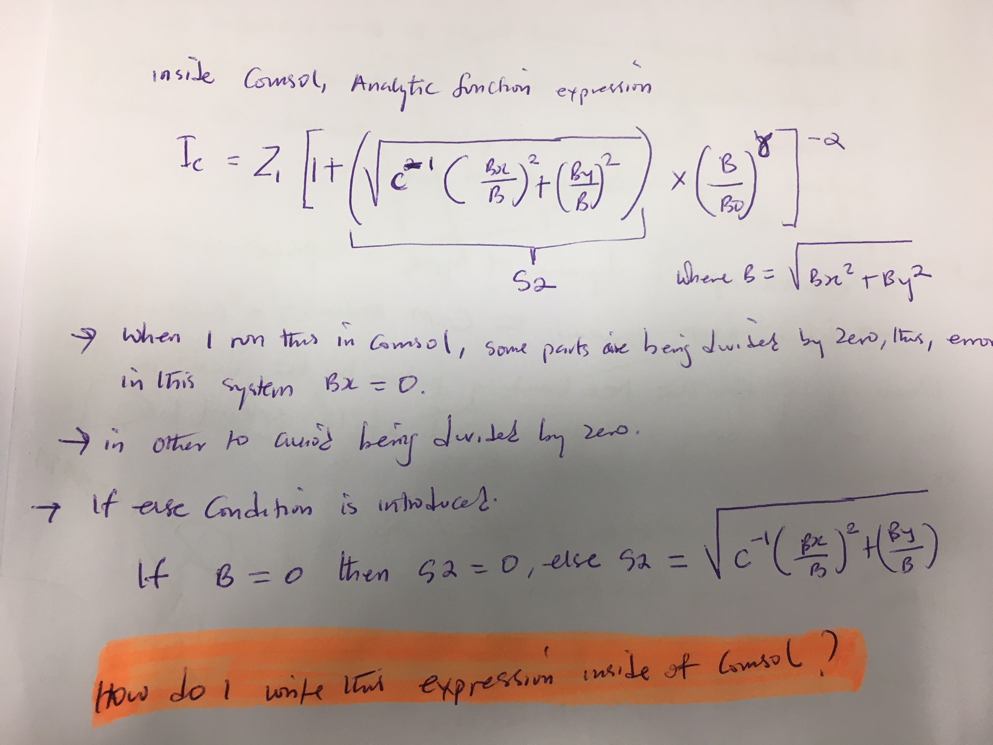

I am trying to define if else condition in comsol. How and where in comsol do I define the following condition attached below?

Try the if-operator: E.g., if(x>=0, sqrt(x), 0). This operator can be used in all edit fields where you enter expressions.
